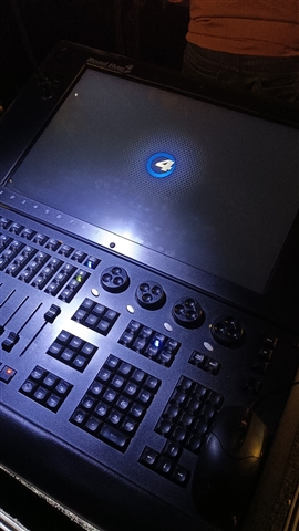

I have The 4.2.1 software AND when I press The output button appears this screen AND i need to restart The desk, does anybody know how to fix it?
Hello, sorry to hear about that. Is this a new show from 4.2.1 or imported from 3.21.1? Can you please send your show file to HESsupport@etcconnect.com so we may take a closer look? Thank you!
As a side note, this appears to be a desktop crash and so there’s no need to restart the console if it happens again. You can hold Pig + Open and press Backspace to open the Launched Processes window. You’ll see the desktop process is not responding. Use the down cursor key to highlight it, then Pig + Set for a right click and select restart desktop. Much quicker than a restart and won’t affect your output.
done! I sent the file
It´s a new showfile!
