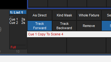

The following syntax doesn't work:
Is this intended behaviour? It follows the Source > Command > Destination syntax and becomes very handy if a LD/Director says: I want to use this Look a several times @ random in the show. Then you copy the Cue to a Scene with the Option State and you can trigger it with a Comment Macro.
Any thoughts on why this should not work?
