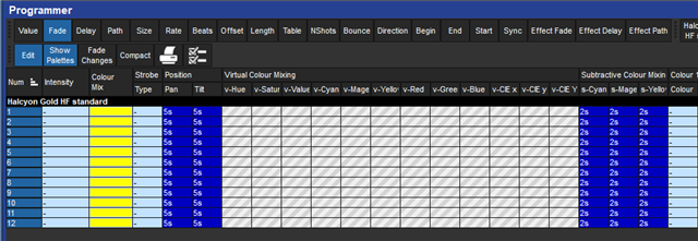

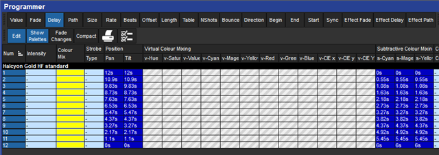

Say i want to record a Timing Palette and i have the following values in the programmer:
If i press: RECORD TIME Color 4 if would give me a Timing Only Palette (Color 4) with Timing for Color Attributes in the Color Directory
If i press: RECORD TIME Position 7 it would give me a Time Only Palette (Position 7) with Timing for Position Attributes in the Position Directory.
Because of both the Fade and Delay Times are there in the Programmer it would automatically become a mix of Global and Per Fixture palette. Fadetime would be Global and the Delaytime would be Per Fixture. So as long as i have 12 spots selected i can apply this palette.
If the Fade Time for all Fixtures was 5 sec and the Delay Time 4 sec it would become a Global Palette just like it works with normal Palettes.
