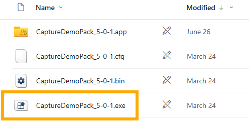

  • Hello,
    Sorry for any inconvenience.  If you download the zip folder and extract the files, there is an exe file that launches the Capture presentation.  If you still can't get it to launch, you can call support for assistance.  As mentioned here, CITP isn't working for PC-to-PC on v5.2 right now.  You would need to run Hog v4.3 or one of the Beta versions.
