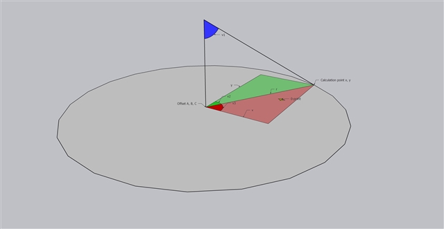

    What is required are two potentiometers that are connected to the PAN and TILT movement of the thing that we want to be able to move like an old follow spot or rebuild moving head. The potentiometer will work as an absolute sensor. I conencted them to A0 and A1 on my Arduino.
    With EOS 3.3 we have a new OSC command "/eos/chan/x/xyz=x, y, z " together with SEM which means that we can now use our old follow spots by mounting two potentiometers for PAN and TILT which makes it more like running a regular follow spot.
    If we imagine that our follow position is the center of a circle and we stand Z=8m up and tilt the follower V1 = 30 degrees. Then we can calculate the circle radius through trigonometry. Tan V1 * Z = r. Since we have the pan angle V2 and the radius, we can calculate X and Y on the edge of the circle and send this information to EOS.
    However, this requires 9 lines of extra code in Stefan Staub's EOS library and your own code to calculate X and Y-position. Wink
    I'am also thinking when V1 is over one angle to rise Z-height instead of giving my system a position 200m away from the 0-point like my testcode send to EOS.
