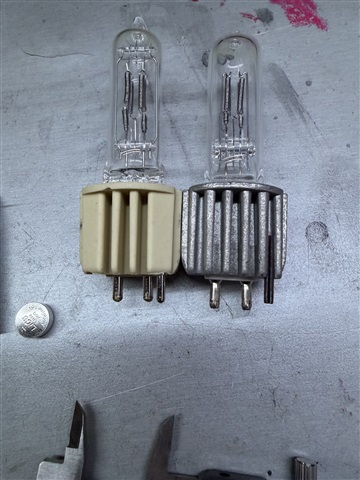

  • I'm having the same problem except I have retrofit assemblies to convert my caps to 750w. The OSRAM lamps with metallic bases don't fit but the OSRAM lamps with ceramic bases do. Here's a video of it and a picture showing the difference. The issue is that the OSRAM metallic bases sit about 2mm lower than the ushio lamps. https://youtube.com/shorts/ihWhTwdemsQ?si=mUfal7ttrHmiJAXQ
