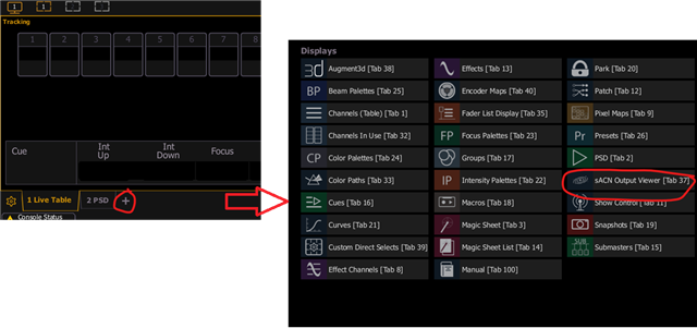

    As you have an IonXE, if you see a network cable instead of a DMX cable coming out of the back of the console you could look at the following for troubleshooting.  On your Ion XE and look at Tab 37 (sACN view).  Either hold down the TAB button (on the console or on the keyboard) and type 37.  Or do the following and click the
    "+" symbol and then open sACN view.
    Even more info here:Using the Eos sACN Output Viewer - Electronic Theatre Controls Inc

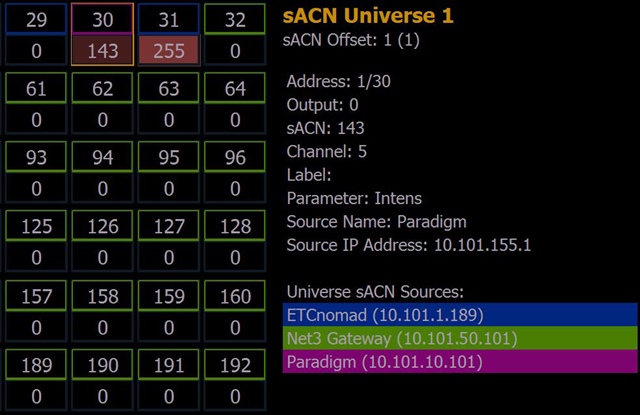

    On this screen if you are using network connections in the lighting system it will show you what value and device is controlling your house lights.  Make sure to know the house light channel number as it's patched or it's dmx/dimmer address.
    You will see a screen like this and it can be a good indicator of what device is outputting and keeping control of your hosuelights staying on.
