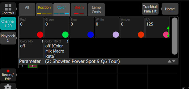

Hi!! I just started to use the etc colorsource 20 today with Showtec Power Spot 9 Q6 Tour. the parled's have UV option. But i don't know how to use it, can someone help please. thanks in advance.
The third page of Color contains all the individual color parameters.
Touch and drag on UV to raise/lower it.
Note:
The Color Picker will set UV to zero and show emitter levels in grey brackets, so if you want a color picker color with UV added on top, choose your color first and then add UV rather than the other way around.
Got it!!! Thank you so much
