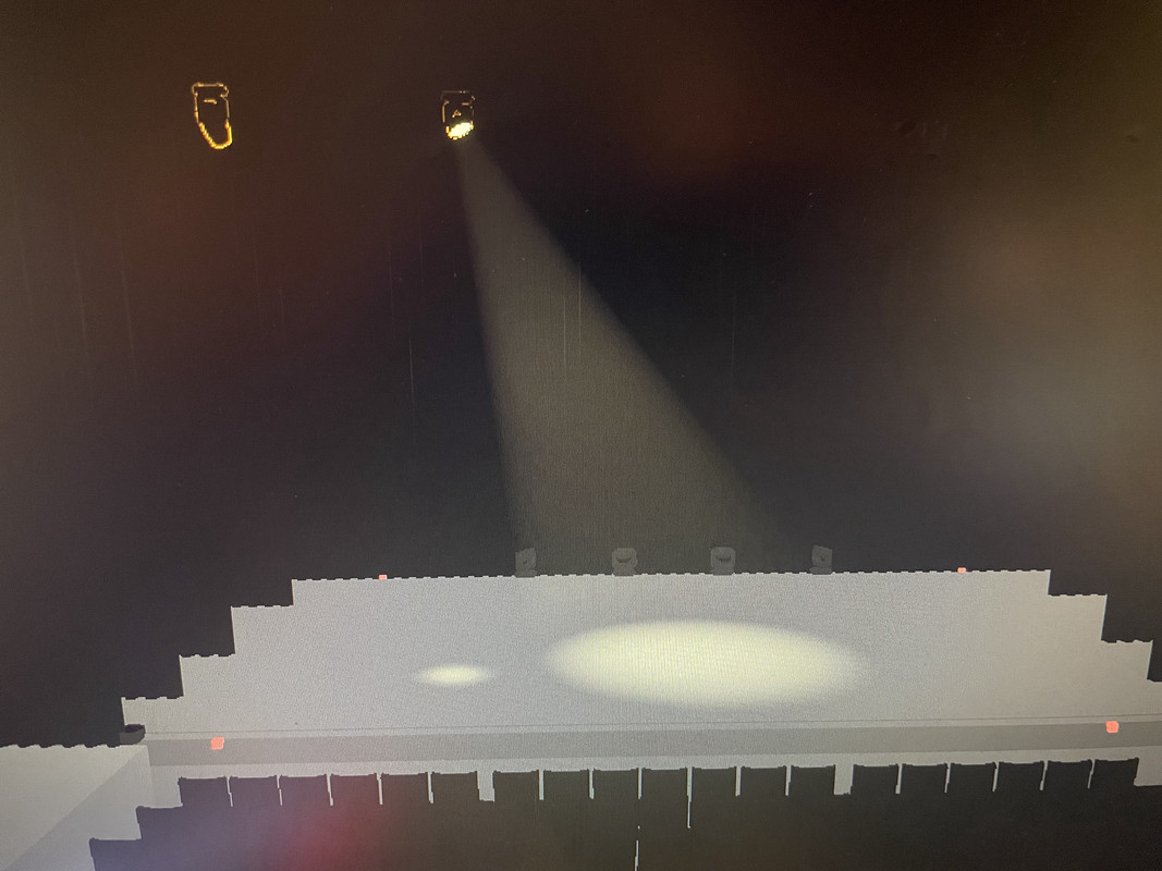

Using Robe T1 Profile M2 (but the same problem with M1 or M3)
On the picture, Robe T1 on the left with ClayPaky Mini-B on the right, both at full with 30° zoom
Robe T1 Profile M2 and Mini-B Basic at Full with zoom 30°

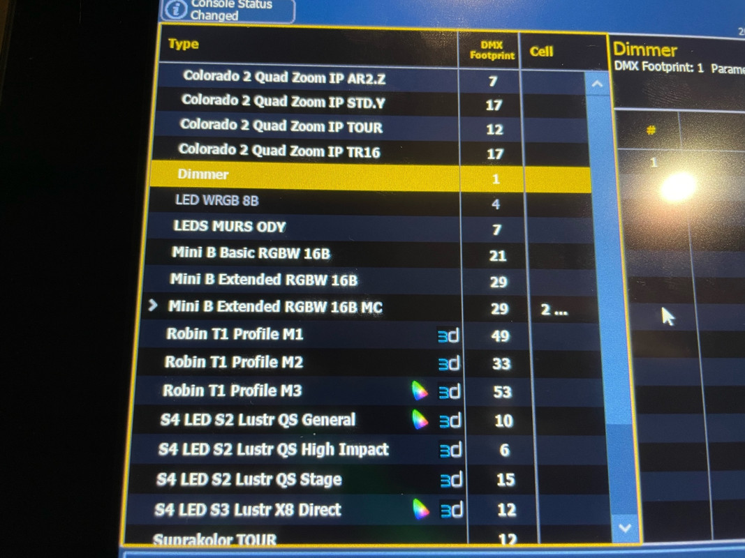

Can you check in Patch if your T1 fixture has an asterisk? This article talks a bit about that.
No it hasn't an asterisk.
I tried to open new show after deep clean, and it neither has'nt an asterisk
I don't understand
