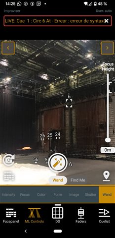

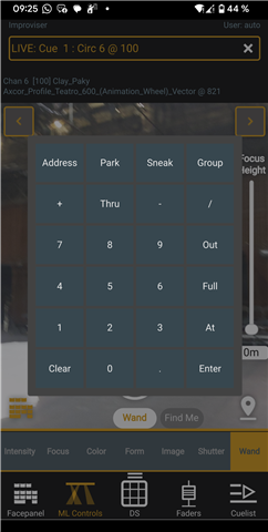

Hi, try for first time wand feature, I can use swipe to zoom or find me but impossible to swipe up or down. Double tap not put box around channel in yellow.
Command line write " circ 6 at - syntax error"

Do you have control of the intensity parameter from the facepanel portion of the app? I am trying to think through why you would get a syntax error
It looks like the iRFR is sending "At" which is not valid syntax when the console's language is set to French.
Yes , it supposed to write @ instead of AT
I had RnD look at that and they are in agreement with sktusings assessment. We will write this up as an aRFR bug. Thanks for bringing this to our attention!
