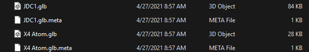

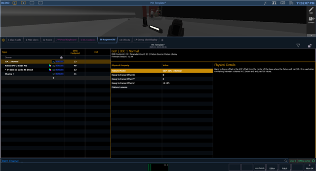

Even though the fixture library claims that the JDC 1 is bundled with an A3D model, patching it in consistently loads the generic Tilting Bar model instead. Manually selecting the JDC 1 model produces different results depending on the fixture personality it's applied to.
