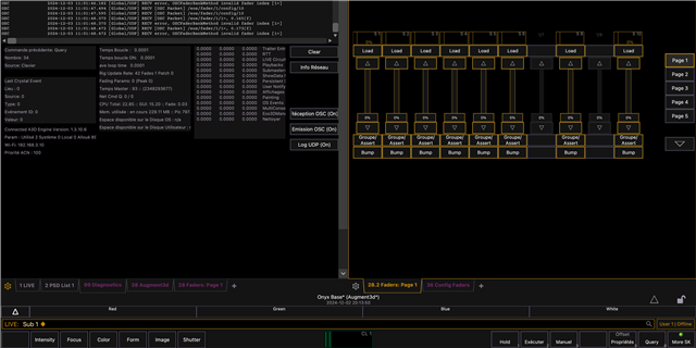

I'm trying to connect a MIDI controller to EOS via USB, and I've read the documentation provided but I can't control my fader.
I've looked elsewhere on the Internet, and I haven't found the answer to my problem.
If I've understood correctly, I've launched the creation of OSC faders with /eos/fader/1/config/10
And then I try to manipulate fader 1 with /eos/fader/1/1=1
But I get this error "invalid fader index"...
