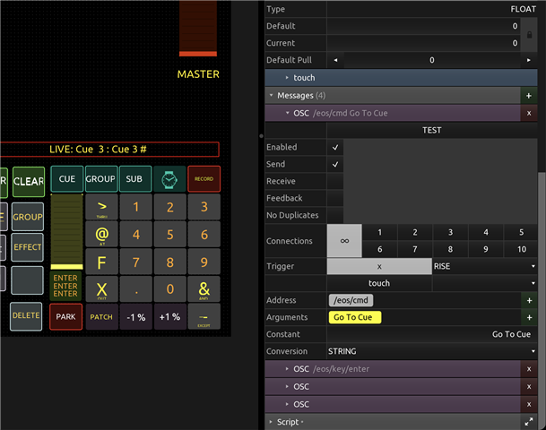

What am I doing wrong? I'm just trying to make a go to Cue ?

You're sending a command Go, a command To and a command Cue. You need Go_To_Cue.
