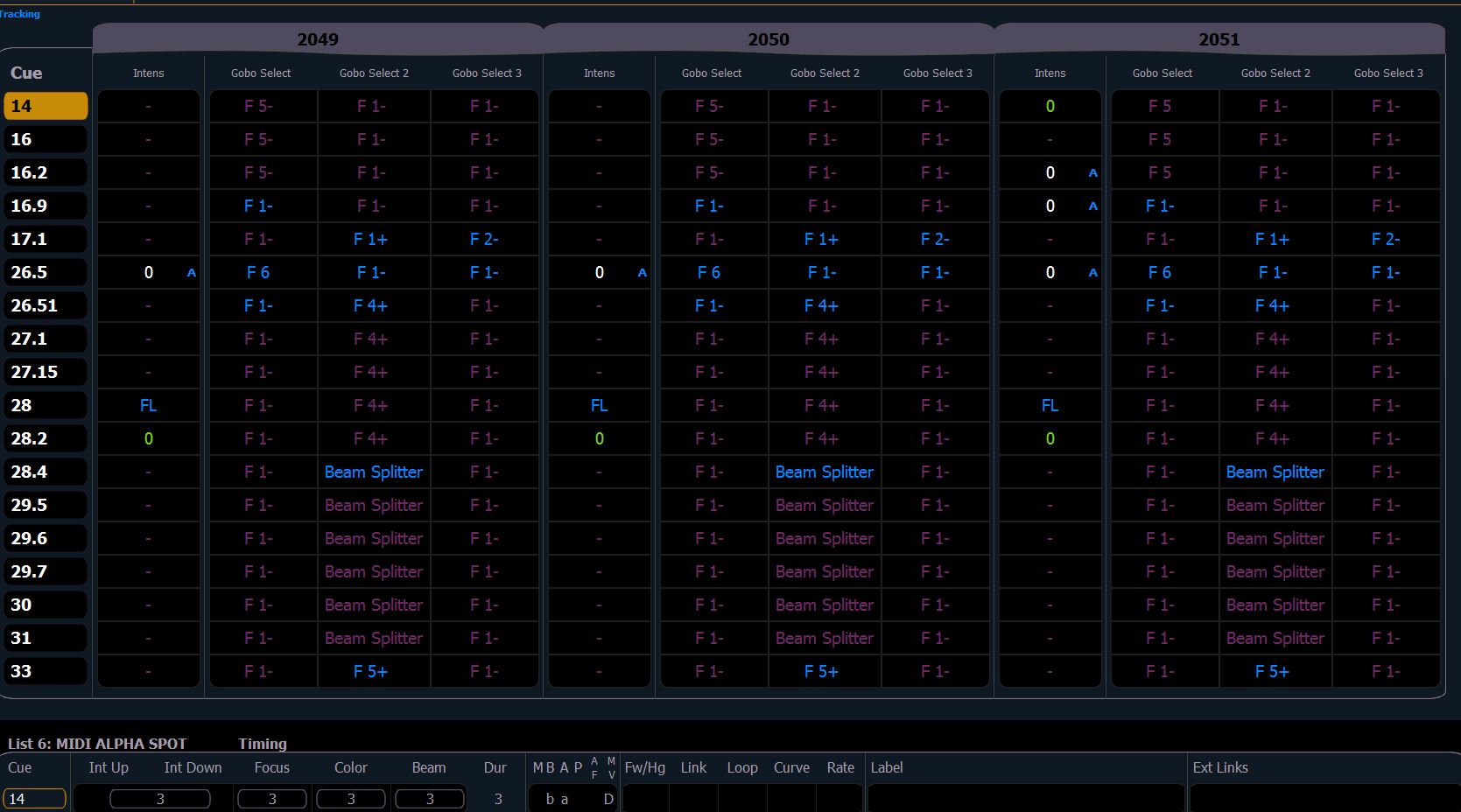

  • So after some more digging on the topic, I'm not sure I'm able to achieve what I need to from the .csv file. What I am looking for is a sortable blind spreadsheet view as shown in the image. Is getting this information to an excel readable format even possible?
    Thanks!
  • Possible? Yes.
    Practical? It depends on your spreadsheet wizardry skills.
    The CSV file contains all the information. However it is organized as a list of cues, and a separate list of channel moves. It would take some clever manipulation to reorganize the data so you can see the levels in a given cue, and even more clever coding to work out all the tracking behaviours, and still more clever coding to colorize everything. It's not impossible but it would be a lot of work.
    It is not clear to me how replicating the blind spreadsheet view would be the fastest way to determine which gobos are used most often. Assuming you are trying to determine which specific channels have non-zero levels then the CSV is likely your best bet.
    Based on your first post, I would suggest upgrading to a more recent version of Excel, or possibly Libre Office where the limit you are hitting on maximum number of rows goes away. You could also use a text editor to extract just the cue information from the CSV and hope that gets you under the maximum number of rows for the version of Excel you are running.
