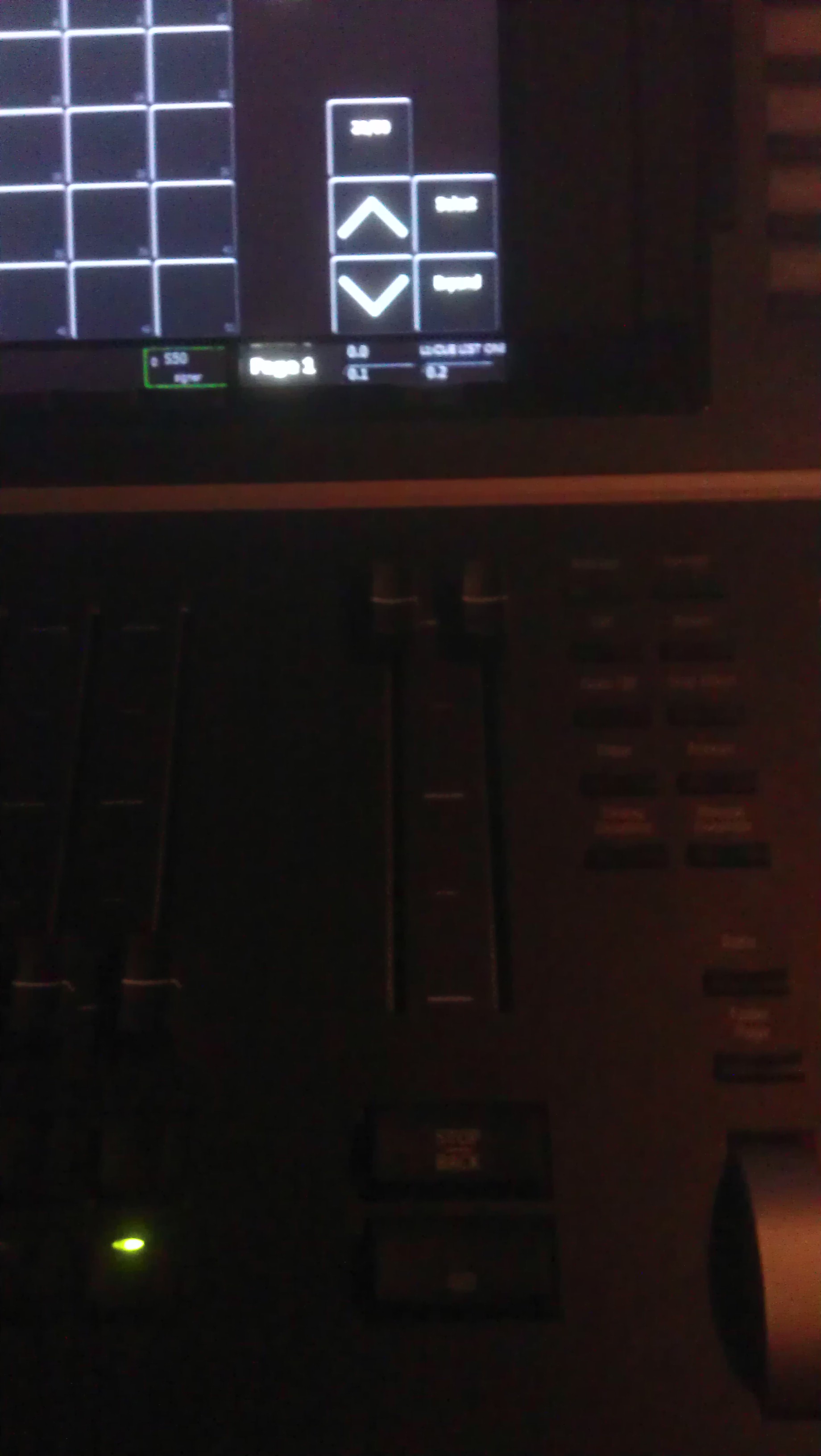

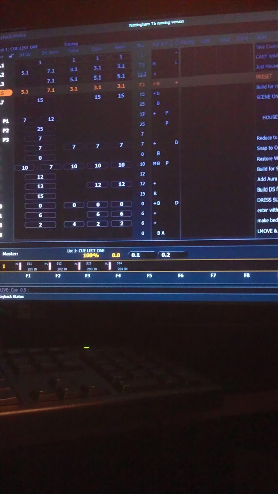

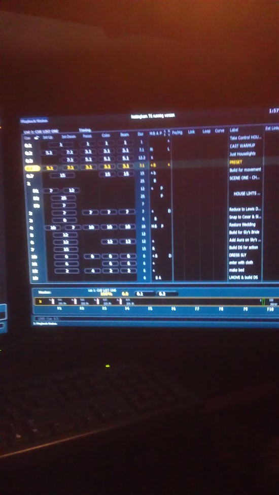

    In the small window above the load button for the main playback that shows the active and next cue number, it was still showing cue 0.1 as active and cue 0.2 as the next. It also showed this at the bottom of the main playback monitor where this is mirrored. This can just be made out in the second picture below.

    I am having a hard time making out the detail but it appears the playback status screen is following cue list one which is being triggered. However the main playback button (small screen) has cue list two loaded. So it makes sense this display would not follow as nothing is being triggered in this cue list.
  • the last pic is the best. there i think i can see that the PSD has cuelist 1 and shows 0.5 active, but the master section at the bottom, which shows list 1 as well, says 0.1 -> 0.2. the small screen area above the master playback section would show the same as the bottom section of the PSD.
    so i don't think there are two cuelists involved?
