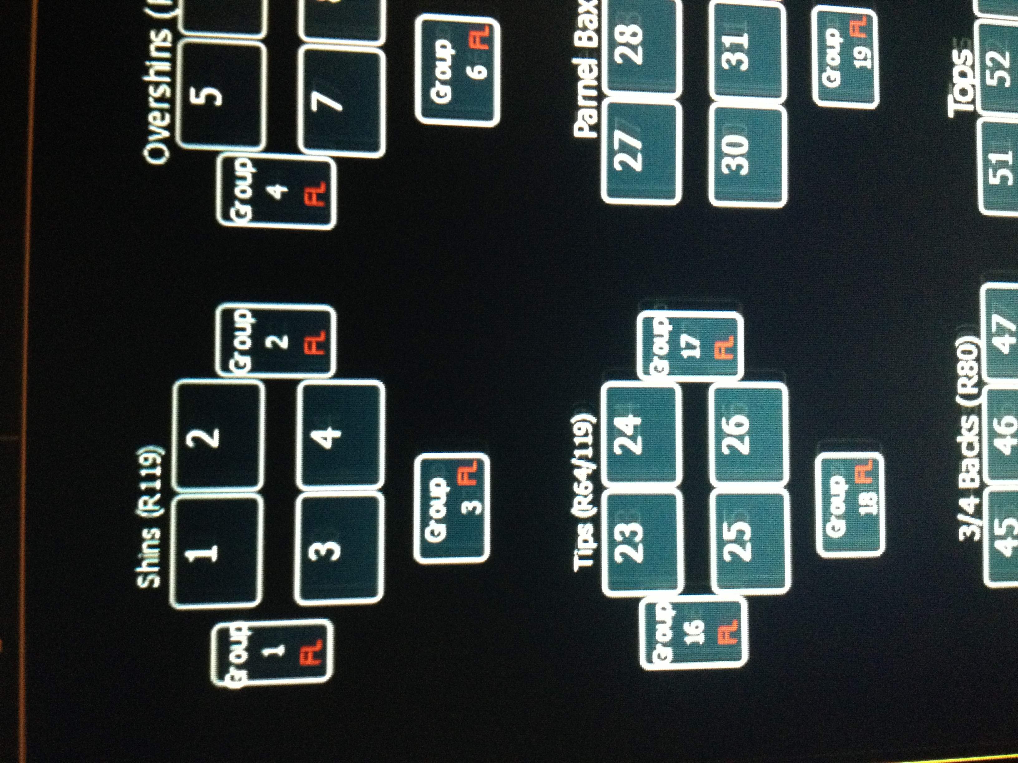

So I made my first magic sheet and when I am done editing and back in live, all groups show a level of full and I can't figure out how to get rid of this.
Any thoughts?

let me guess, you used one of the stock fixture symbols and changed the target to Group? when you insert one of the stock fixture symbols, some of their fields get populated by default. one of them as intensity and one as status. set both fields to None and you should be fine.
if you use a custom symbol (imported by yourself), no fields are populated. the stock symbols on the first page in the edit toolbar, get the fields populated depending on their default targets.
I used the generic Group button but and used the headings of "Target Name", "Target Id', and "Intensity", the rest of the fields say "None"
there is a photo there of what it looks like on the live screen
Use the above suggestions...
Groups do not have levels on the Eos/Ion systems. They are selection tools only. When you leave the "intensity" tag on them the console doesn't have anything to fill that and it gets the "default" information.
