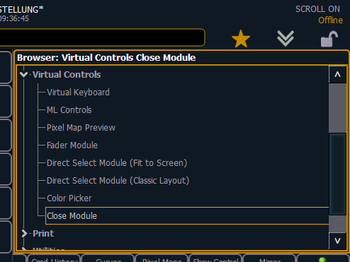

What do i press to actually close it. There is no close moule option in the browser? at least i dont see it.
As per Ueli's image, with this window open, click on the Virtual Keyboard, then double click on Close Module. A 2nd window will pop up where you will see highlighted in which location the Virtual Keyboard is currently open. Click on that and then the Close button.
