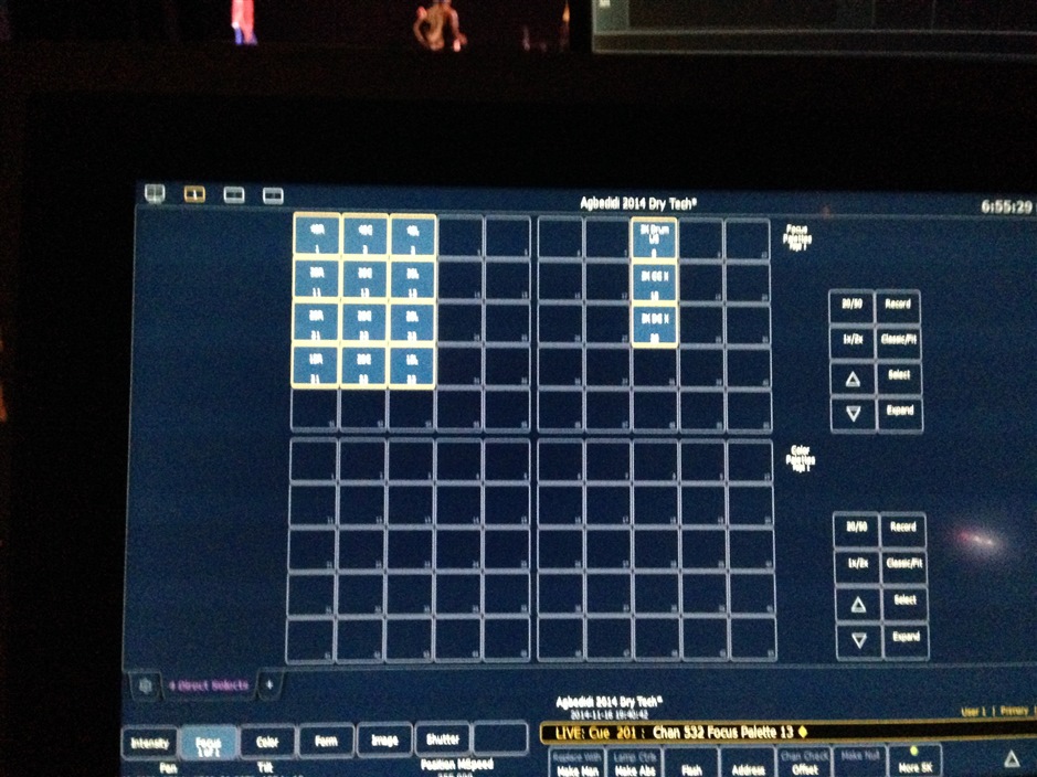

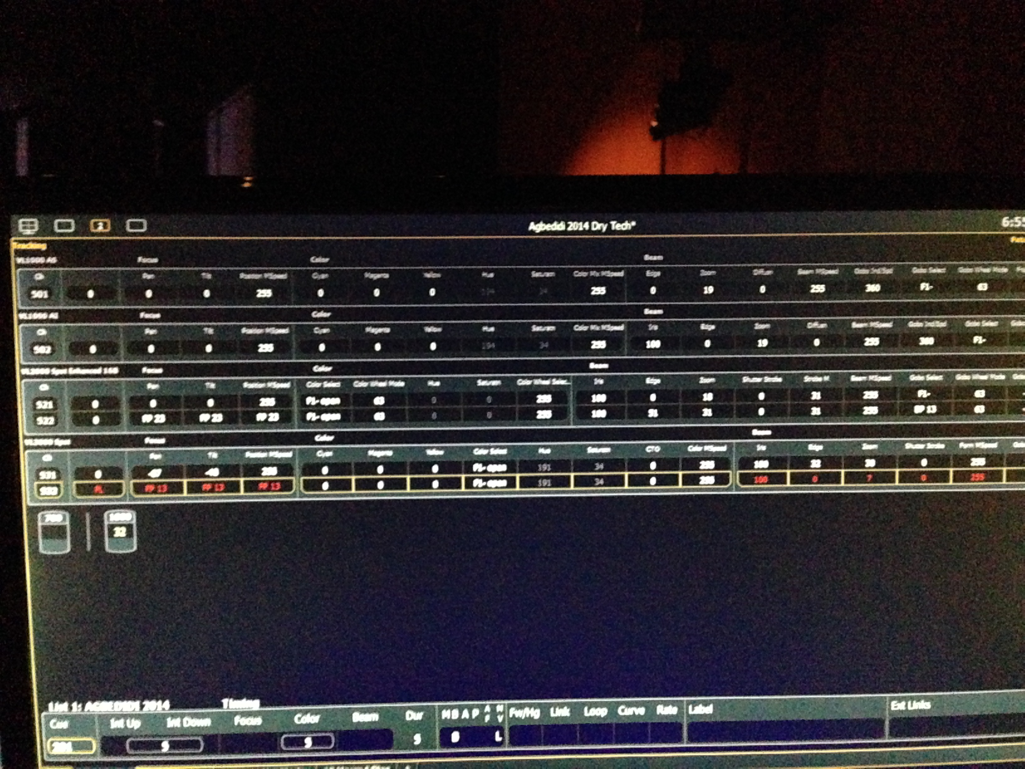

I'm on a Gio running version 2.2.0.9.0.96 and when switching between snapshots my two internal displays get locked into the Blind display background color. after a few more switches between snapshots they return to the Live display background color. I've attached images. Has any one else run into this issue?
  • This isn't just a snapshot bug, the DS background doesn't refresh properly when switching workspaces (WS).
    If you have Live Tab open in 1 WS and DS in another, go into Blind with the channel tab (so the background goes grey), switch to the DS WS and then go Live and the DS stay with the grey background.
    I think this maybe already written up.
