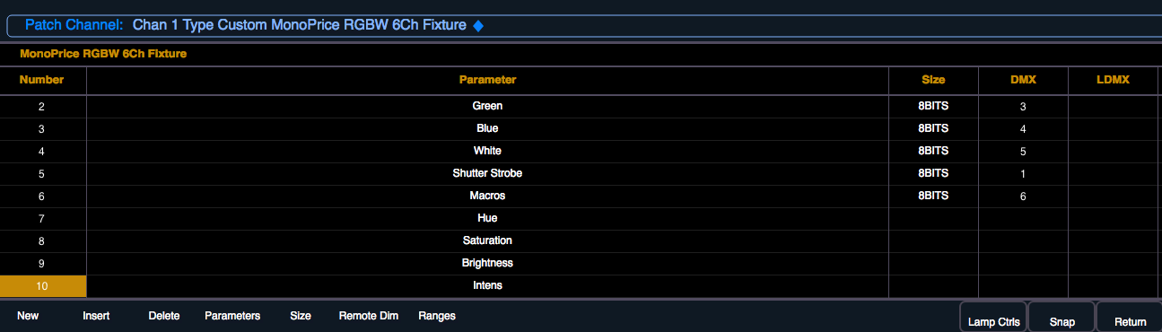

    This maybe to late but I've made a fixture for you which should be a little more user friendly.
    I'm not using the dimmer values in the first DMX address but I've used the Generic RGBW fixture and used the virtual Intensity parameter, this will cheat and use the RGBW parameters to dim the fixture, this should also give better fades then their profile.

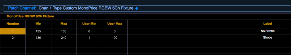

    I've set the first DMX address to be a Strobe param and be at DMX 135 by default (so it's full), you'll need to use Shift+Strobe Encoder to make the fixture strobe.
    I made this quickly so I've not added the extra Disco stuff on the 6th DMX address.
    If the upload works you should be able to merge this into your showfile (please save before you do any merges) and I've not double check the fixture..
