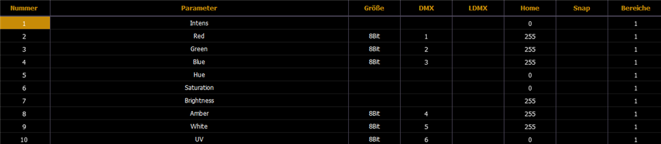

    i went to patch, fixtures, new, edit, and added parameters. intens was already there, then i aded red, added green, added blue. after blue the console added hue sat brightness . then i went on and added amber, added white, added uv. exited, copied, edited again, and all worked as expected. we seem to be doing something differently.
