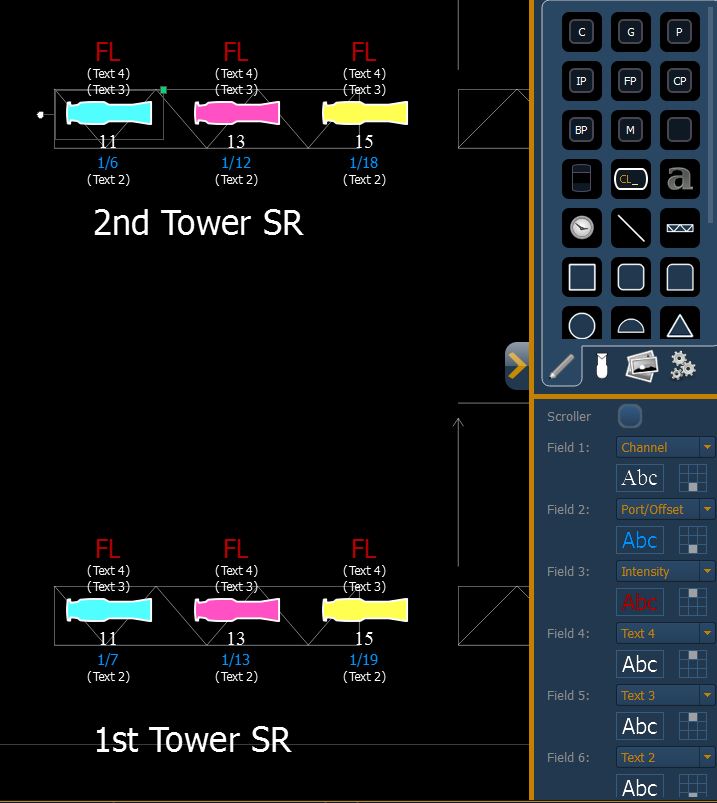

    The workaround I use for this is to assign the object in MS as an Address (Target) instead of a Channel (Target).  Adding a Channel Field to that object will still allow you to display that information along with Address (Absolute or Port/Offset).
    In the pic below, Channels 11, 13, and 15 all have multiple dimmers patched to them.  In this instance, the object is assigned to be an Address.  I added the Address (Port/Offset) and Channel information to the fields for that object.  The trade off is that you can't click on it and control it as you would a channel if using ML Controls, Direct Selects, etc.  This trick works well for displaying information but not for interactive control.  If you click in the object, Address populates on the Command Line as opposed to Channel.
    Another trick I have used for this is to create a second object below the Channel object.  The second object can simply be assigned to an Address (Target) with an Address field and you can take away any borders or fill colors so it mimics a label.  After the Address is assigned and I am done editing the two objects, I will group them together, that way if I need to move items around in an MS I only have to move one object.
