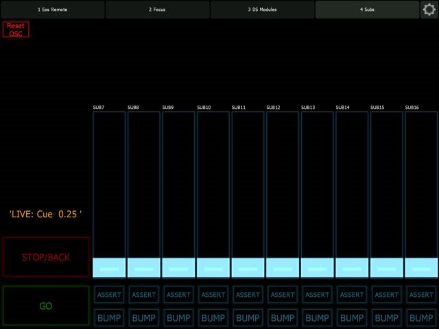

Is there a specific reason it has to be dmx in? Currently you can use UDP to control the console and OSC is currently under testing. I have several OSC based submaster remotes and even Arduino based hardware submaster systems.
