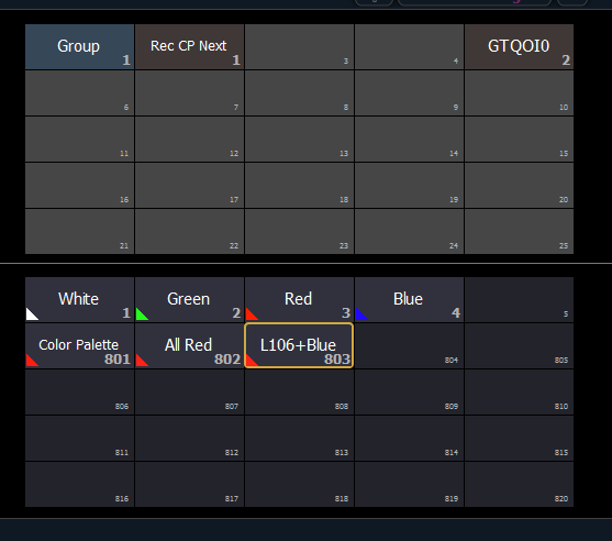

    To run with this, I would open a Direct Selects tab with two Banks.  I'd make the first Bank Custom and add my Macro button there.  I'd make the Second bank Color Palettes, and activate Flexi.  That way, as I add new Color Palettes, I see them added to the Direct Selects:
    So when I'm asked for a color again, I just select the channels, then tap that DS button to get it called up.  If it looks good on one light, I can [Color] [Recall From] [Chan] x onto the other lights that want it.  And if I want to make more modification to the color, I can either re-save it, or just make a new Color Palette and write out what's different in it's name ("L106+blue+lighter")
