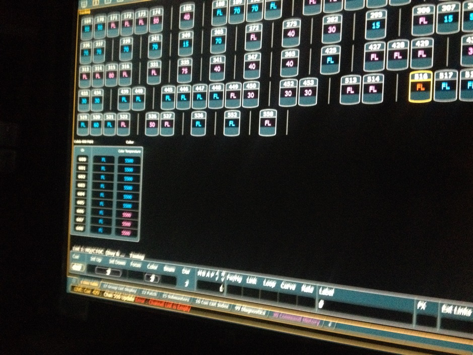

Hi gang.  I recently switched to 2.3.2.
I have a channel that will not update.  (#516 in the picture.)

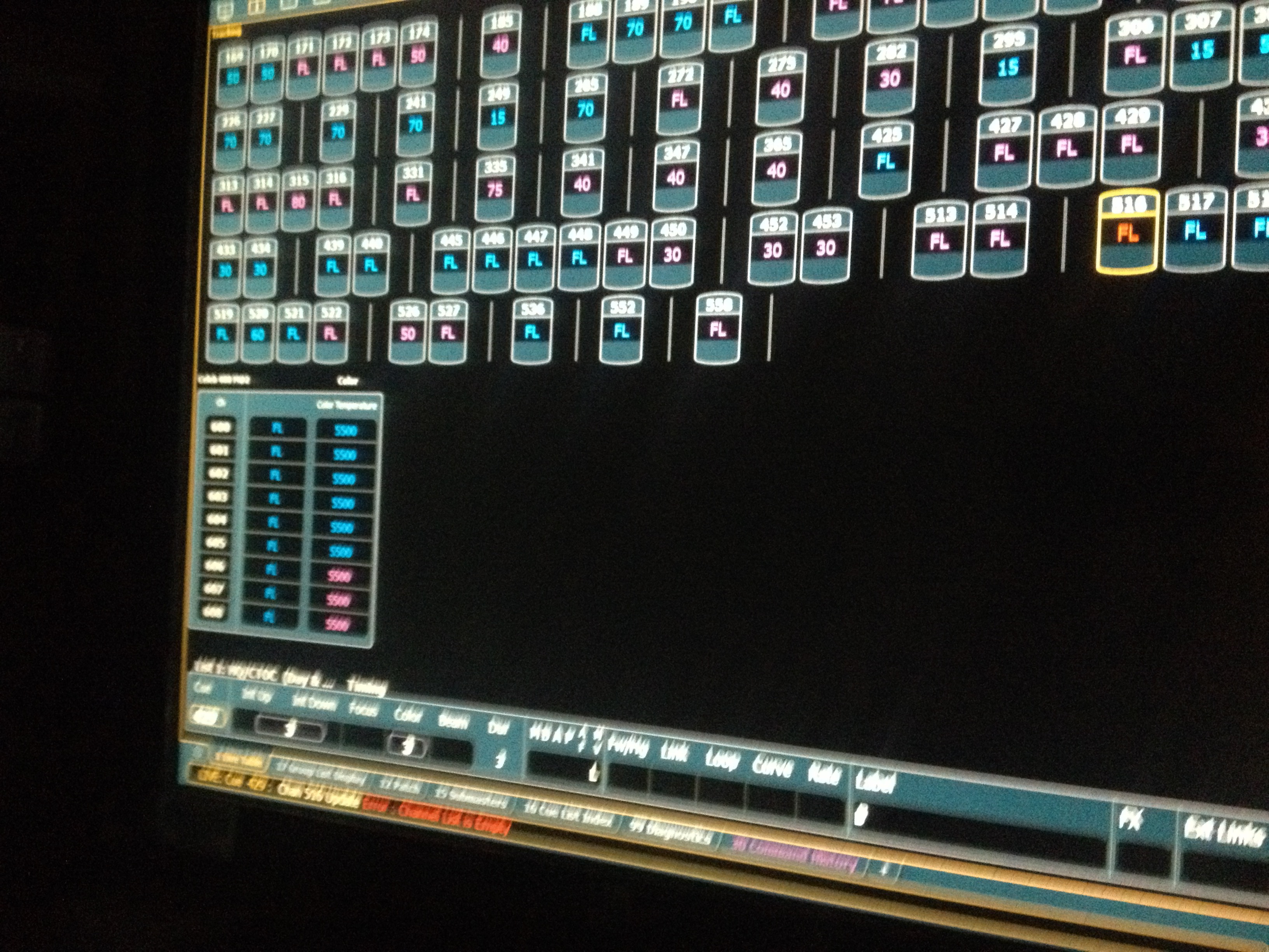

If I use [Update], the channel is not listed, and stays red after the update.  If I select the channel and try to update it alone, I'm getting the "Channel List is Empty" error. (SEE picture.)
Of NOTE:
This channel is also at 50% on an Exclusive Sub. (Additive, Proportional, HTP, Exclusive Timing0/0 Manual)   Before the software update, I would keep this Exclusive SUB at 50% as a work light, but be able to bring the channel to FULL and then [Update]. Or conversely, I would save it to 0 or OUT and the [Update] & auto playback would take the channel back to it's SUB (HTP) level.
Thanks, Matt
UPDATE:  After recording the channel into the next CUE (which worked), the update behavior worked as usual.  I would say I stumbled upon a BUG, but I cannot replicate it now.
