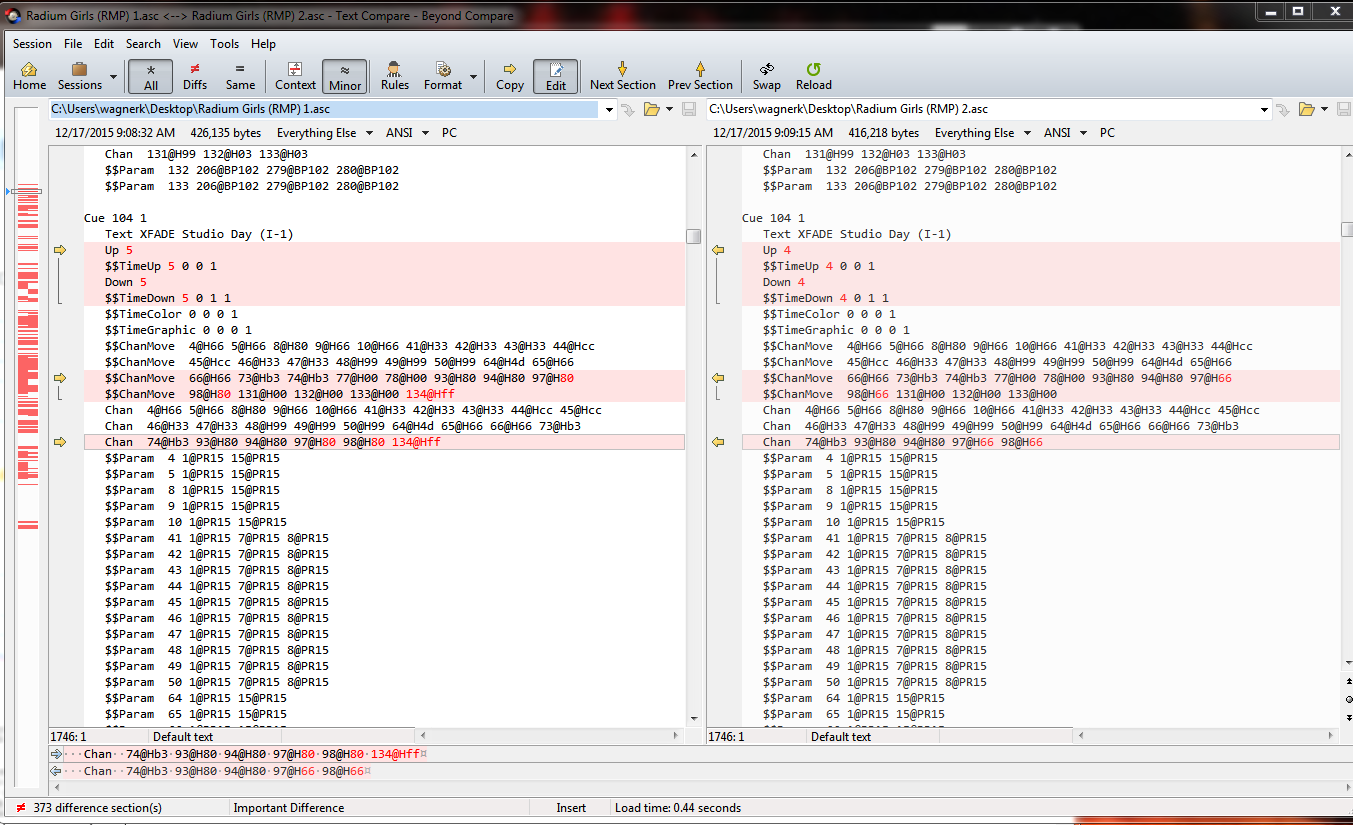

  • Hi Nick,
    So I did a bit of brainstorming with a colleague of mine at work and we came up with a solution.....
    1. Delete 2nd list
    2. export it to FFP
    3. Undo delete
    4. Repeat steps 1-3 with List 2
    5. Open file Level_Cue_Param_1 of list 1 in Excel
    6. Copy Columns D,F,I to new spreadsheet
    7. close file (Excel does not like to open two files with the same name)
    8. Open same file for list 2 and copy underneath first set of data
    9. In the data tab use [Remove Duplicates] (select all three columns)
    10. E voila you are left with List 1 and all the way at the bottom of your spreadsheet with the differences to list 1
    Thank you all for your input and guidance......
    (Work)Life is so much better now ;)
