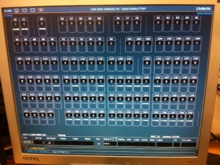

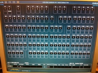

following problem:
when I do an autoblock clean some of channels move to another part in the cues. This cues is a Block, so it was not a partial or autoblock.
Has somebody else this problem or is it just me? What am I doing wrong? I have a lot of cues with parts. So I got a lot of Trouble...
Here the two pictures before and after autoblock clean.
  • Unfortunately I can't see anything in the pictures because they are to small.

  • I'm sorry for the photos. Tomorrow I will post better ones.
    The blocked channels are not in part one. And what I know understood is, after doing Autoblkclean they move to part one?
    So years ago the blocked channels have been in part 8. So all Long Running Shows should have the same problem when they do the Autoblkclean ...

  • It's ok I've zoomed in on my ipad and I can see it Lion King Hamburg, Don mentioned you were having issues with auto block clean.
    Jeanne gave me this showfile last week let me take a look at it again, it may not affect the playback.
    Really all the parts should be moved so part 8 becomes part 1, this is what we've done on all the other Lion Kings and is much safer for the future. Eos default part is part 1 not part 8 so this makes sense but I expect you have Asserts on each block cue which isn't helpful anymore.
    I couldn't see any problems with effects tracking or not stoping that Don mentioned, if you're still seeing that let me know and I'll take a look.
