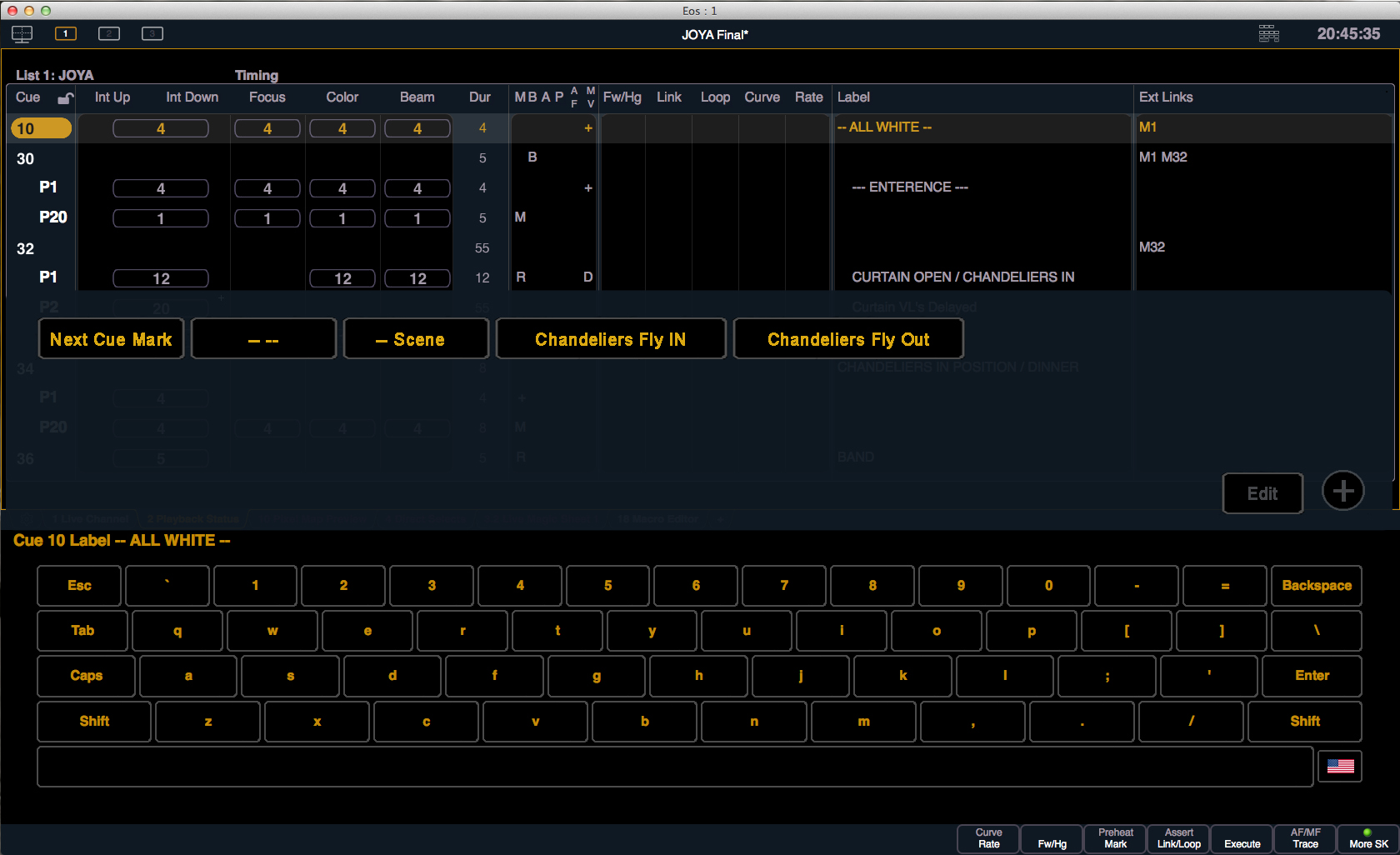

Hi,
so i made macros to label cues with our standart names that appear in every play, like "Light behind curtain", "Audience 100%", "Audience 50%", "Audience 0% / Workinglights off" etc.
Those macros work like when i press label twice, they delete anything that was in the name before.
But i would like to combine the names so i can have 2 macros, one for "Audience 0%" and a second one for " / Workinglights off" press them one after another and in the end i have "Audience 0% / Workinglights off" in the cue.
Version is 2.3.1 on all desks.
Also tried it in 2.3.3 offline editor and couldn`t get it to work.
