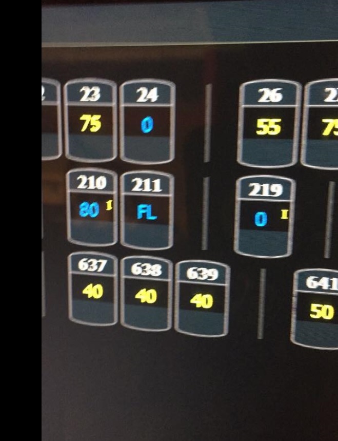

Hello all,
Ueli asked me to post this over here (I originally posted to the FB eos page).
Running 2.3.1.
2.3.1.9.0.12
I am cueing some fixtures out using an inhibitor. Some channels on the tombstone display visually go to 0 some do not. In all channels on the inhib the yellow i appears. IRL the fixtures do dim. Bug?
As discussed on the forum the inhibitor always dimmed the fixtures on stage.  If the tombstone's level was FF then I could see the level change in the tombstone as it went up and down.  If the level was less than FF (here in the picture the cue level for Ch. 210 is 80) then the yellow i appears but the level doesn't visually change.
