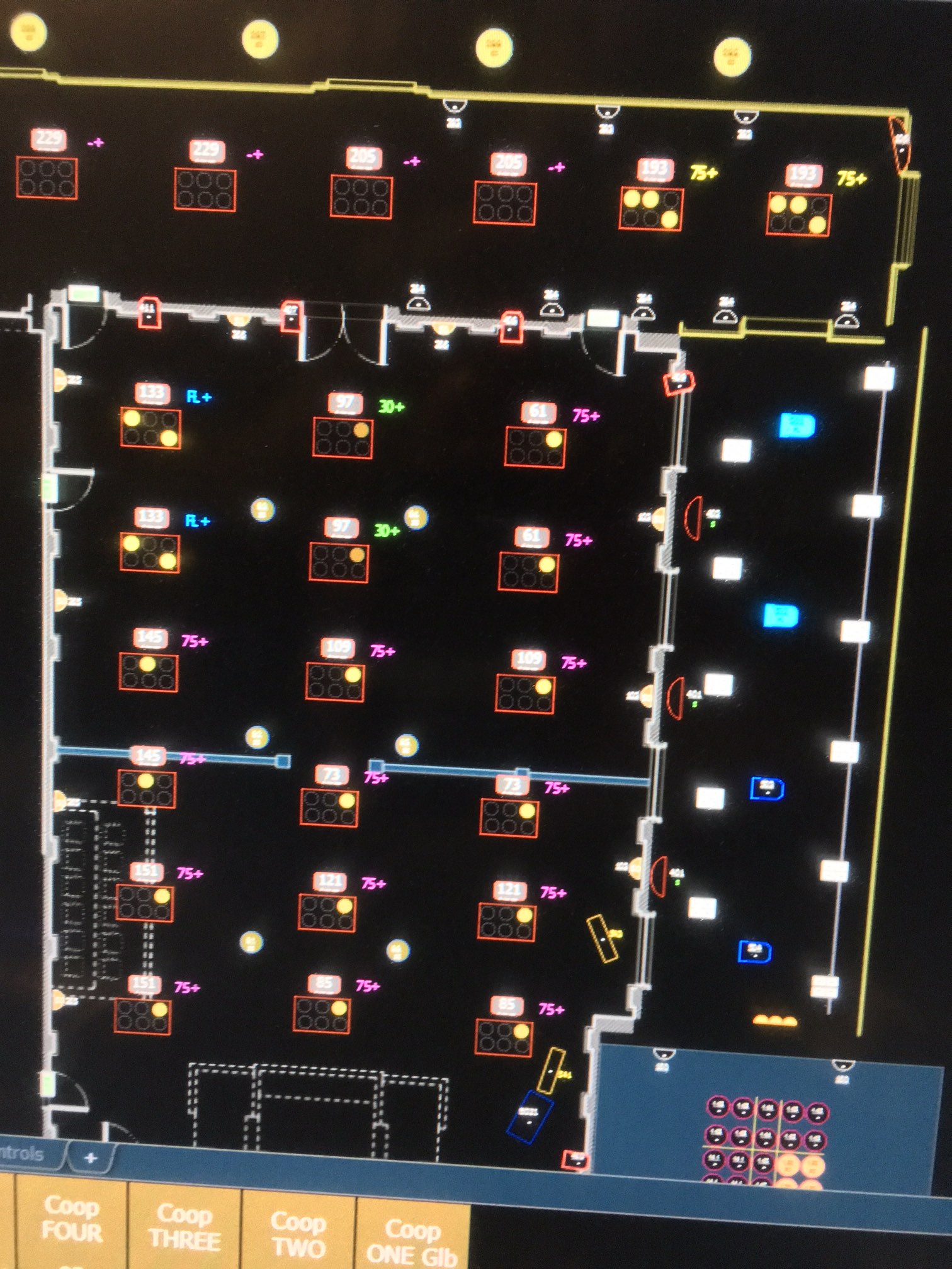

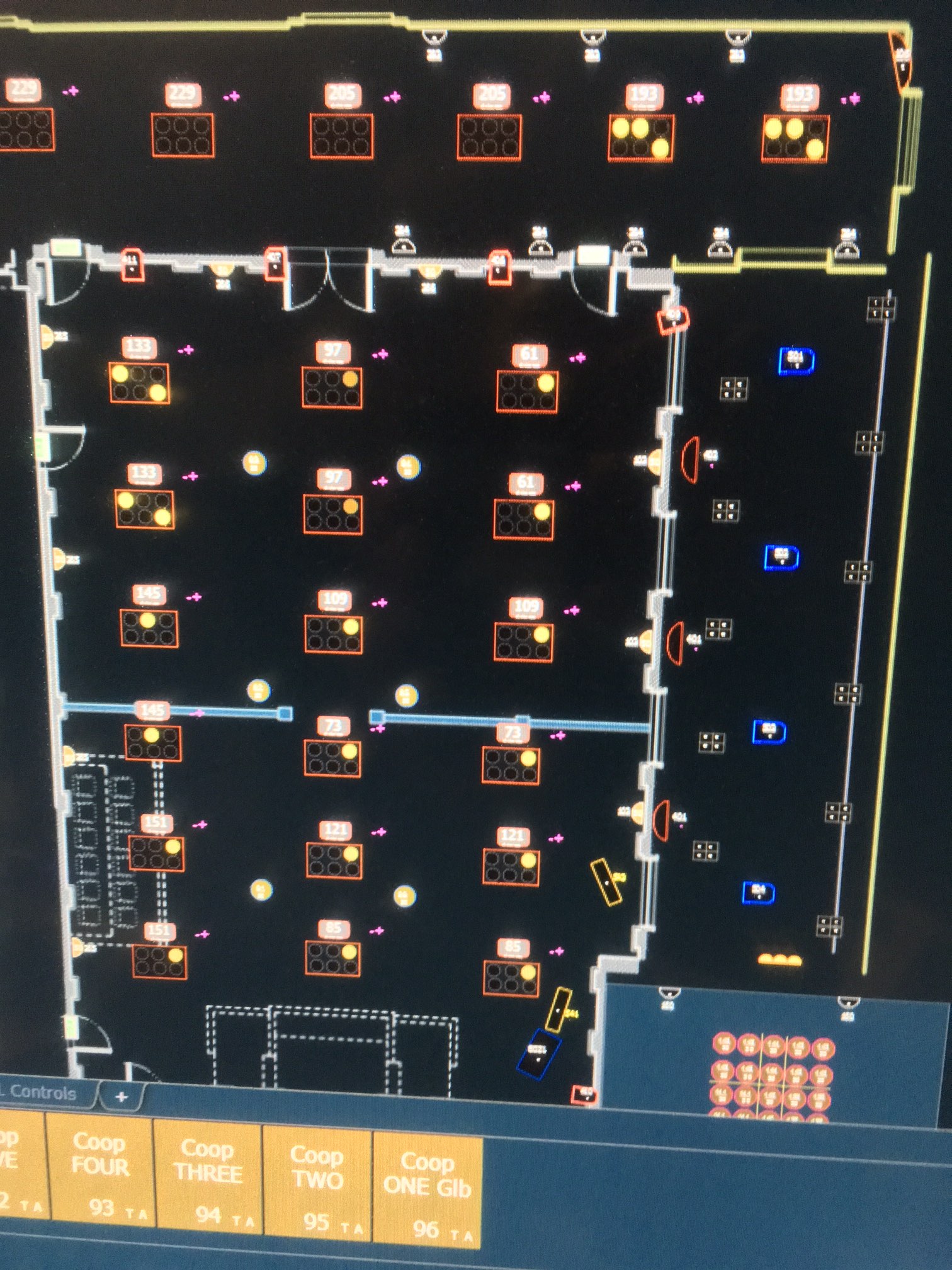

Hello all.  In TV, I traditionally make a MS plot of my sets which I use in various ways. In the 1st MS, I've got Coops which I've created by having the individual globes represented by their "Address" as the target. This works fine in LIVE, but in BLIND (2nd MS), the "Link to Channel Intensity" option of these addresses stays with the LIVE representation. In other words, I cannot go look at another scene in BLIND and see, on the MS, how many globes were up. (Of course the channel display has the correct answer.) Anyone have a solution for this type of multi intensity fixture to represent itself properly in BLIND without making the fixture 6 individual channels/cells? Thanks (Ion 2.3.3)
