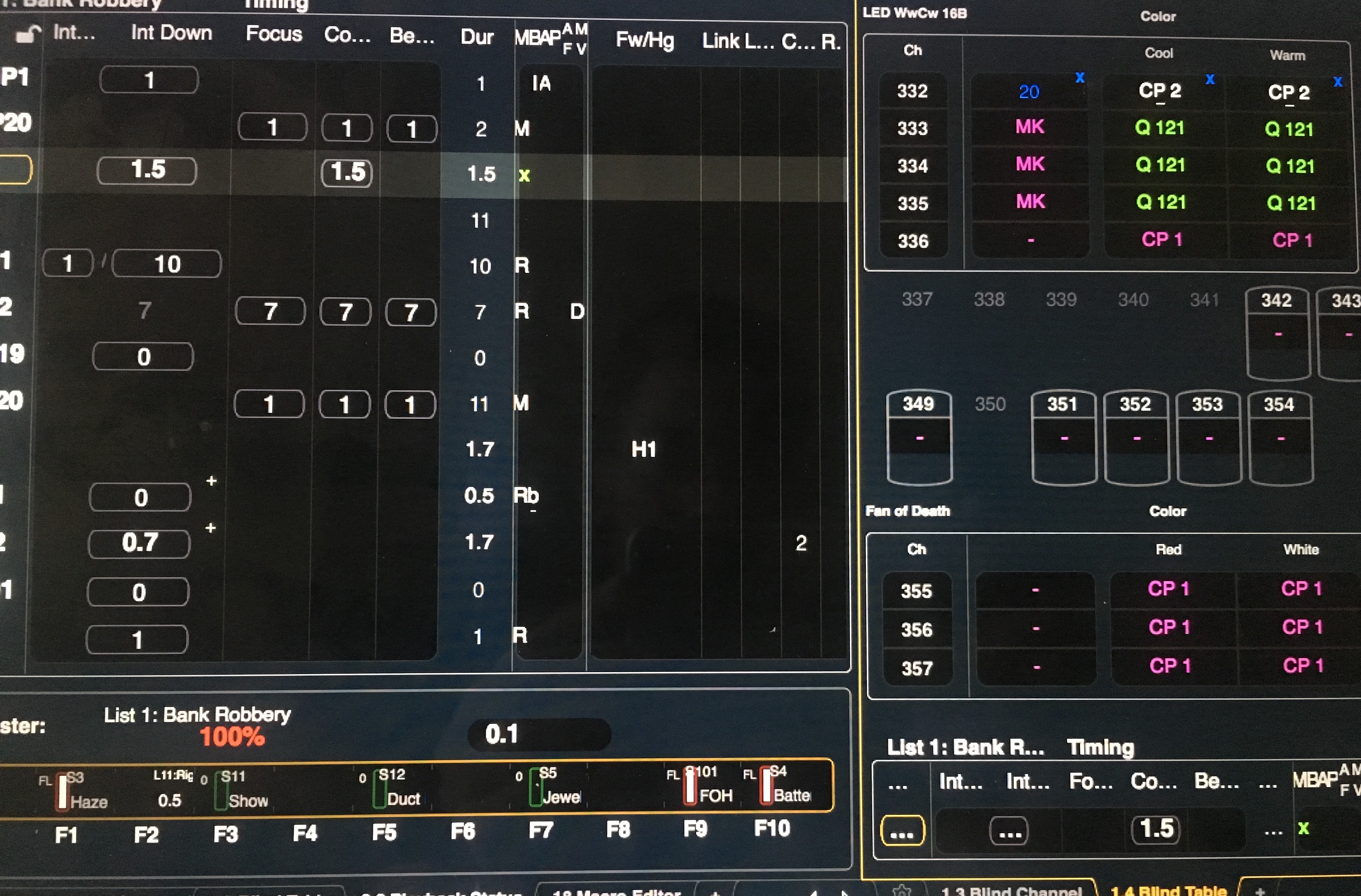

I understand that the x flag on the PSD means that the cue has a broken mark.
I have found channel 332 also has the x in its tombstone - i believe this means that it is channel 332 that is causing the x flag in the PSD
It seems that channel 332 has an auto block on its colour (its underscored)
How do I go about removing the auto block and making channel 332 mark in cue 119 part 20?
I have added a pic of the screen so hopefully that helps.
