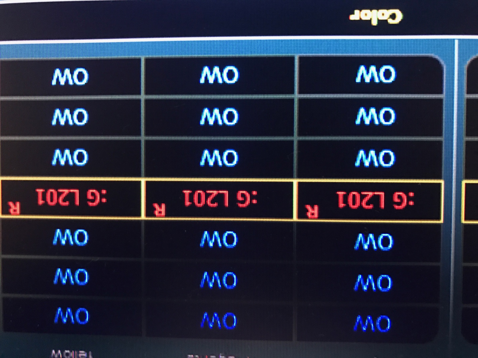

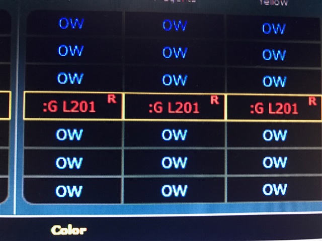

Hello - does anyone have any ideas about the : before the G in the photo below?
No idea what I've done, however when I select L201 in this way the output colour is green.
Interestingly, even though the colon appears before any colour selected this way, the expected output is only wrong on VL fixtures in the rig, Martin, GLP and S4 Lustr's are all behaving as expected.
I have left a message with tech support as we are currently in tech,  but if anyone has any ideas I'd really appreciate it.
Thanks.
David
  • Reposting Anne Valentino's comment from the same thread on the Facebook group which answered the question.
    "There are three ways to get the gel color - brightest, best spectral match or hybrid (1/2 way between brightest and spectral). Brightest will just yield the gel number. Best spectral is identified by 1 dot in the lower left cell. Hybrid is 2 dots (or a colon if you will). This can be chosen with the color picker tile (Brightest, Spectral, Hybrid). It can be overridden by holding down shift when you pick a gel tile. That way you can quickly toggle between the three states to pick the one that best suites your purposes."
