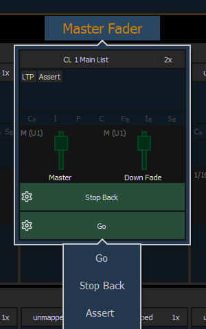

Hello Thomas,
If you open Tab 36 Fader Config, you should see a blue button toward the top that reads "Master Fader". Click on that to gain access to the settings for the Main Playback, including the Stop/Back button. You may need to hilight the button, then press the gear symbol to the left of the button:
