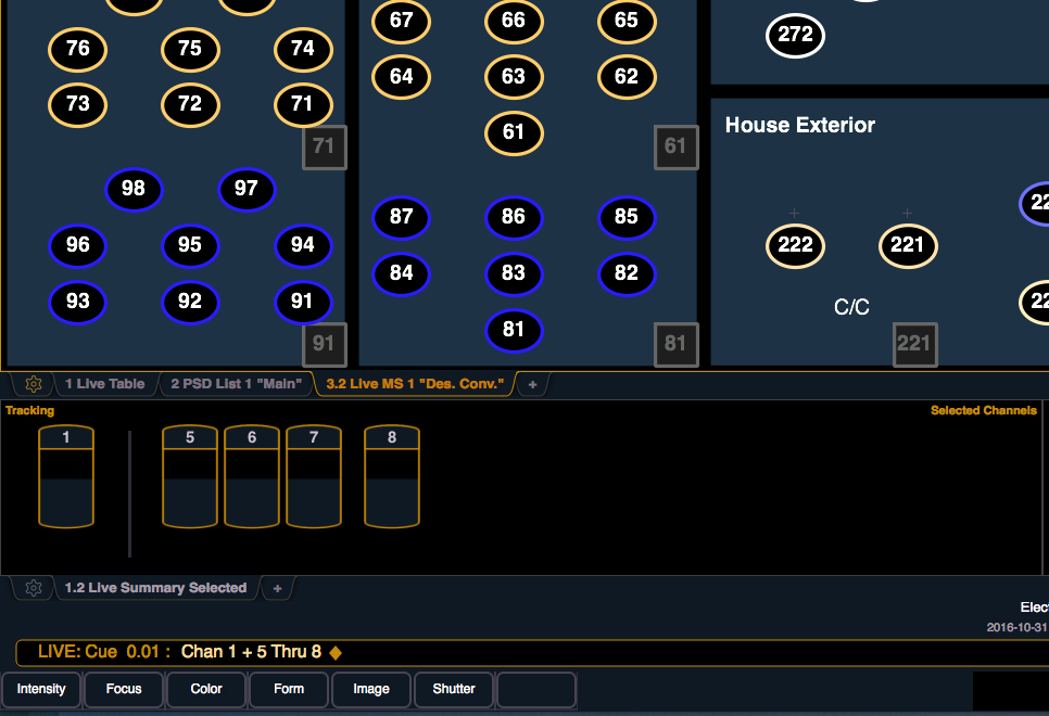

Is there a way to create tombstones in magic sheets that show selected channels opposed to static, preset channels? This is probably something really simple that I should know how to set up but I'm not seeing it. Thanks!
You can't do this directly on a magic sheet, but you can split your workspace into frames and set one to show tombstones with Flexi Selected. I usually set up my screen to show a magic sheet and also a Flexi Manual tombstones tab so I can quickly see if I have manual data I need to update. Flexi Manual also shows any channels I have selected (regardless of their manual data status).
