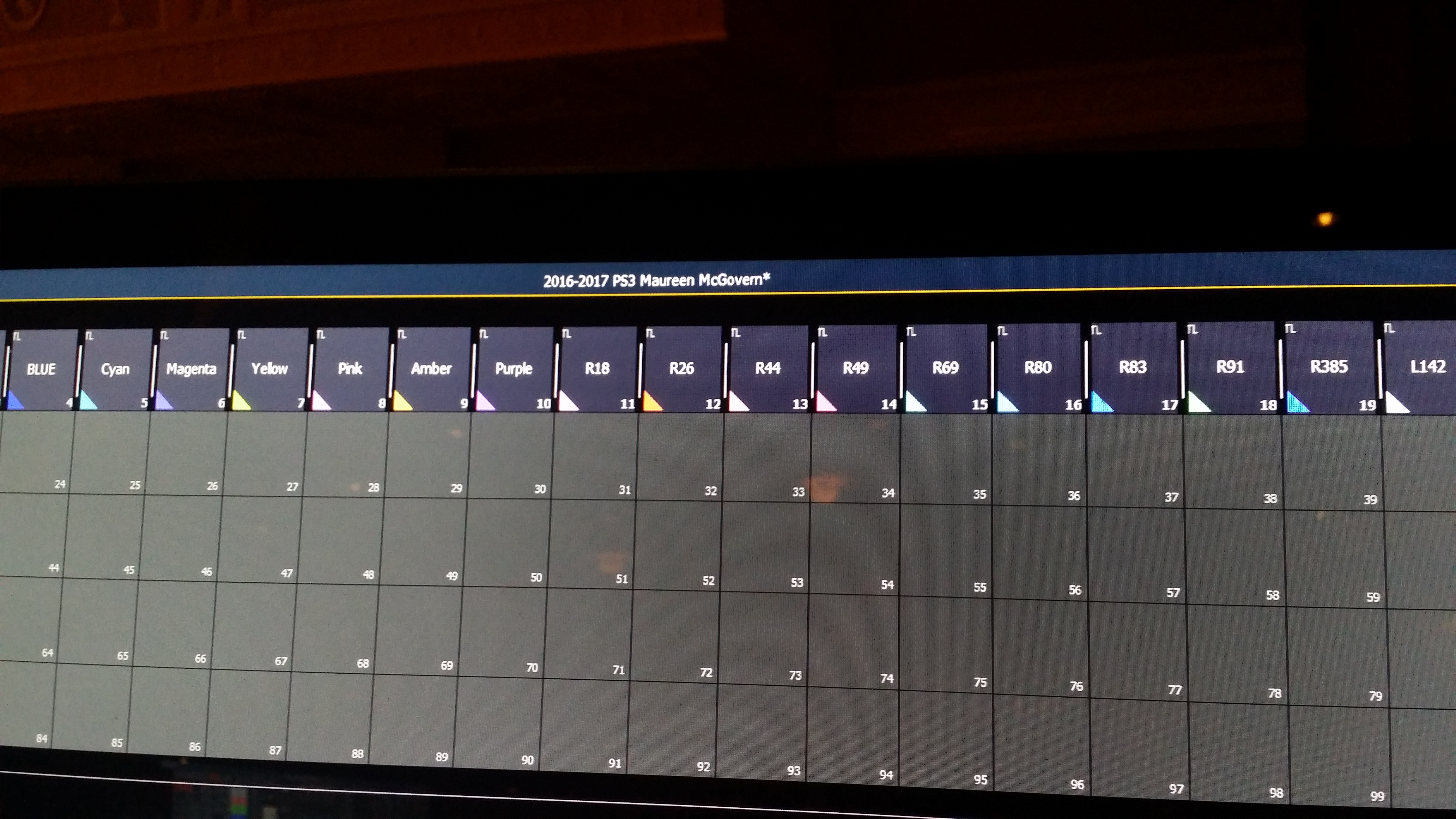

First off, thanks for all the new features.  The option for removing the blank tiles representing gaps in palettes is something I wanted for a long time.  However, I think it still has some issues.
In this photo you can see that it is putting bars where it shouldn't:

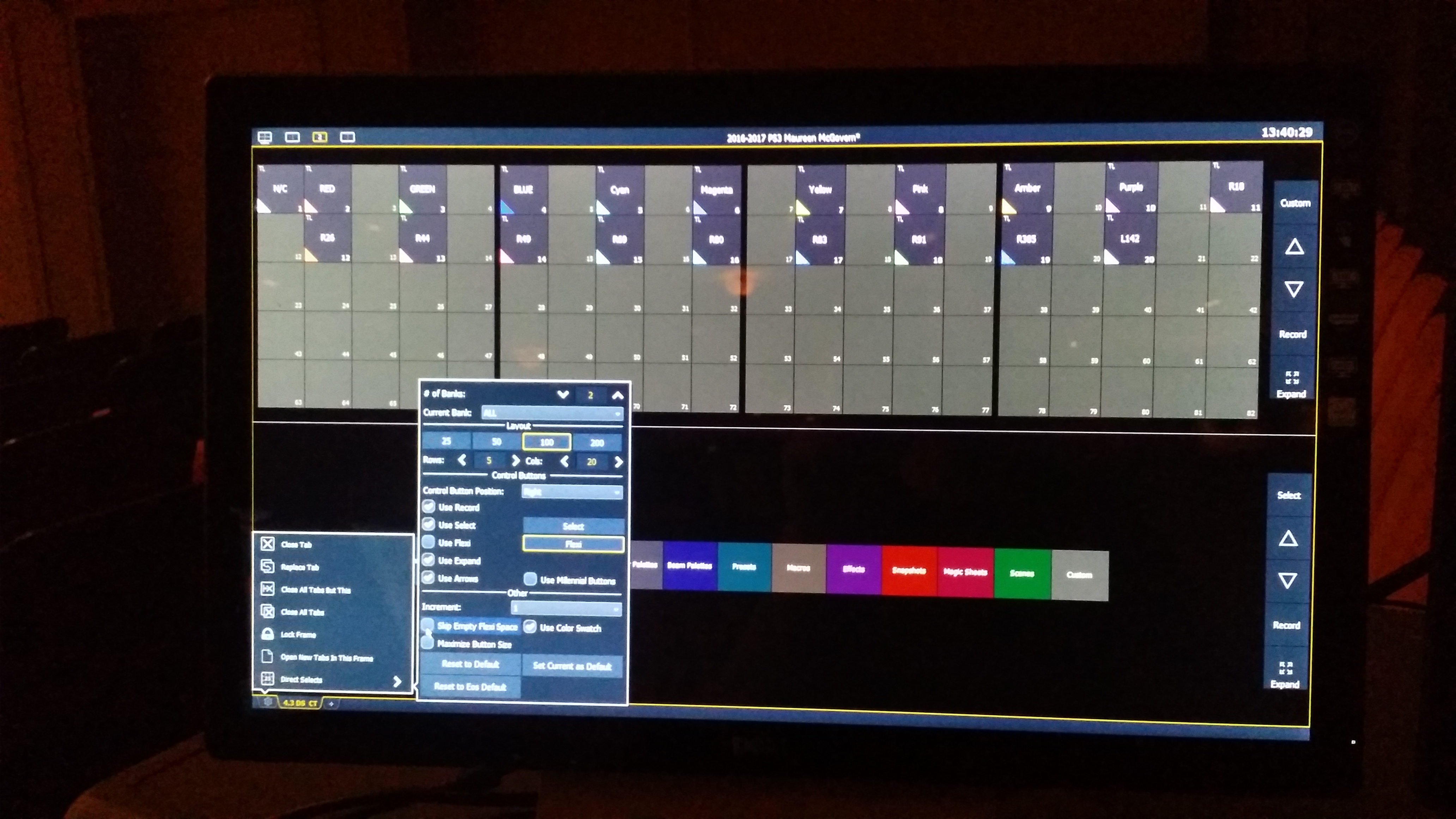

When I turn off flexi, I see that there are some empty tiles duplicating the tiles I have which I assume is the source of the extra lines:
I've noticed that sometimes when I've seen this, a recall of a snapshot fixes it.

    It looks like you're using the Custom Direct Selects to make the page you're looking at - is that correct?
    In your second photo, I'm struck by the "duplicate" buttons between the assigned ones - I think those shouldn't be there, and that's part of the SCR. The bars are a symptom of that.
    I find that Resetting the workspace and re-opening the DS tab will get those buttons looking correct again - until you Flexi the buttons again. You could record a Snapshot just after resetting/re-opening, and at least be able to get back to that.
    I've entered SCR 39877 for the behavior I'm seeing.
  • Matt,
    Yes, that is correct. It was a custom DS.
    Thanks!
