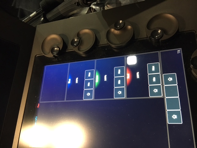

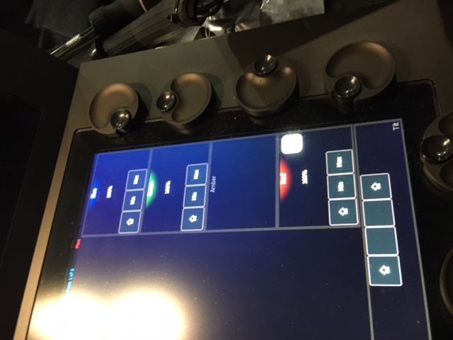

    To be sure it wasn't show file specific, I created a new show file as you suggested. I patched a couple generic fixtures (a RGB & a RGBAIUV). I then created a MS channel button for each.
    When I tapped the RGB channel MS object, it posted it's channel (11), unterminated, on the command line. What I get on the Encoder screen is the photo below. Please note the inactive 'Amber' on the 3rd encoder.
    Once I hit <enter>, I get the photo below. Notice how the 'Amber' goes away & the other colors consolidated.
