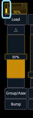

  • Hello Doug,
    I apologize, I misunderstood your comment about "playback with the bump buttons".  One of our developers realized that you meant assigning time to the Sub, then pressing the Bump button to get that Sub to play back in time.
    On Tab 28, you see this indicator:
    That was added in v2.4.   It will go up and down as a timed fade from a Bump of a Sub is occurring.
    In v2.5, it's jumping to the end position.  It also gets confused when there are effects in the Sub.
    We have an SCR 39829 for both of those behaviors.  We're looking to get it fixed in the next software release.
