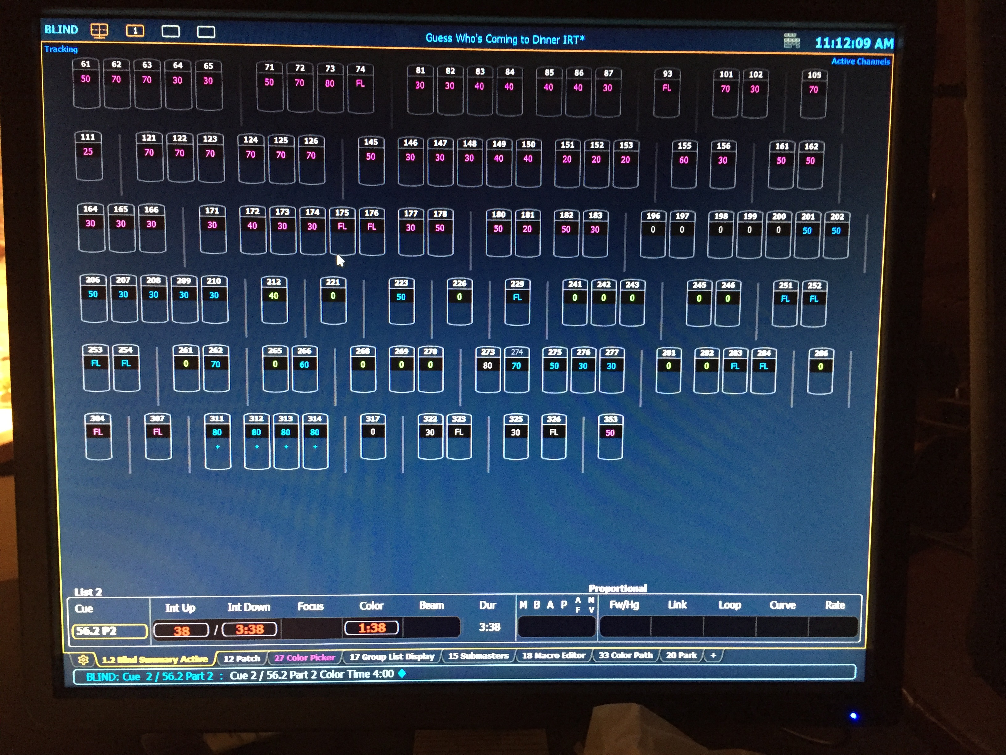

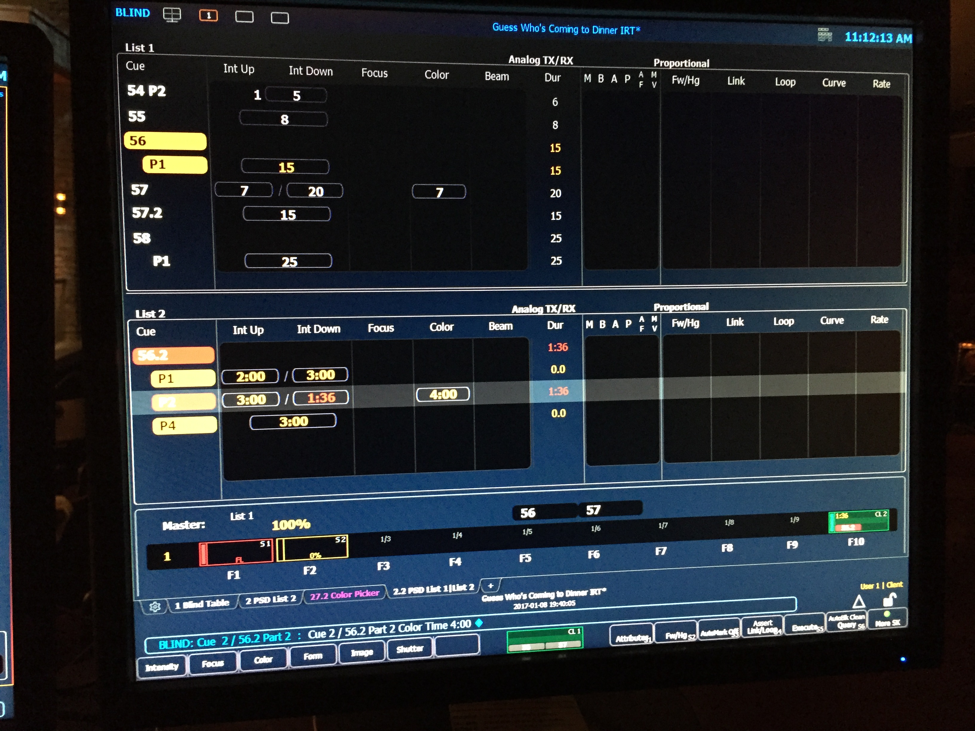

Running 2.4 Eos Classic software and came across the following.  While running two cue lists, Q 56 executes 2/56.1, along with another set of linked cues.  Two things I saw.  While running the cues, I go into Blind and Cue list 2 Q56.1 has frozen its time on the channel tombstone view.  It does countdown properly on the PSD.  Also, I am running a long cue of time 4 min/8 min with the Color time set to 6 minutes.  This color time is running LED fixtures.  After 6 minutes, the color has not completed nor are any intensity channels moving. I believe these both are bugs.  I have a show file and pictures of the screens.  These were taken within seconds of each other.  You can see the two different timings.
