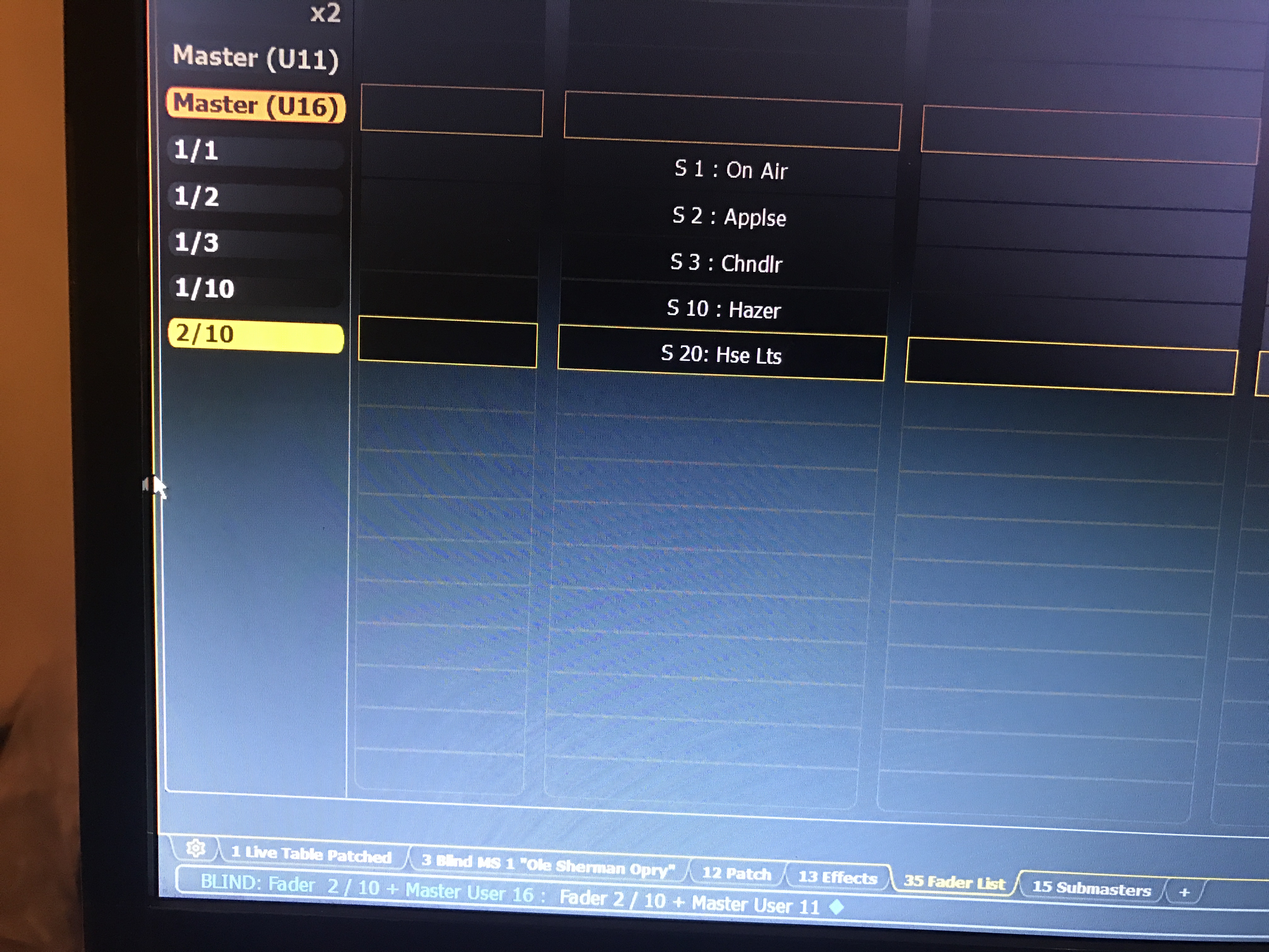

 Running 2.5 on my XP Ion with a 2x10 fader wing attached.  I also noticed this when I was using 2.4.1 (did not install 2.4.0)
If I click on a submaster I can generate a new master fader out of thin air.
Also- once generated they do not seem to be possible to delete.

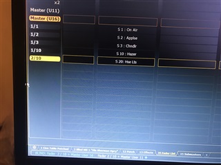

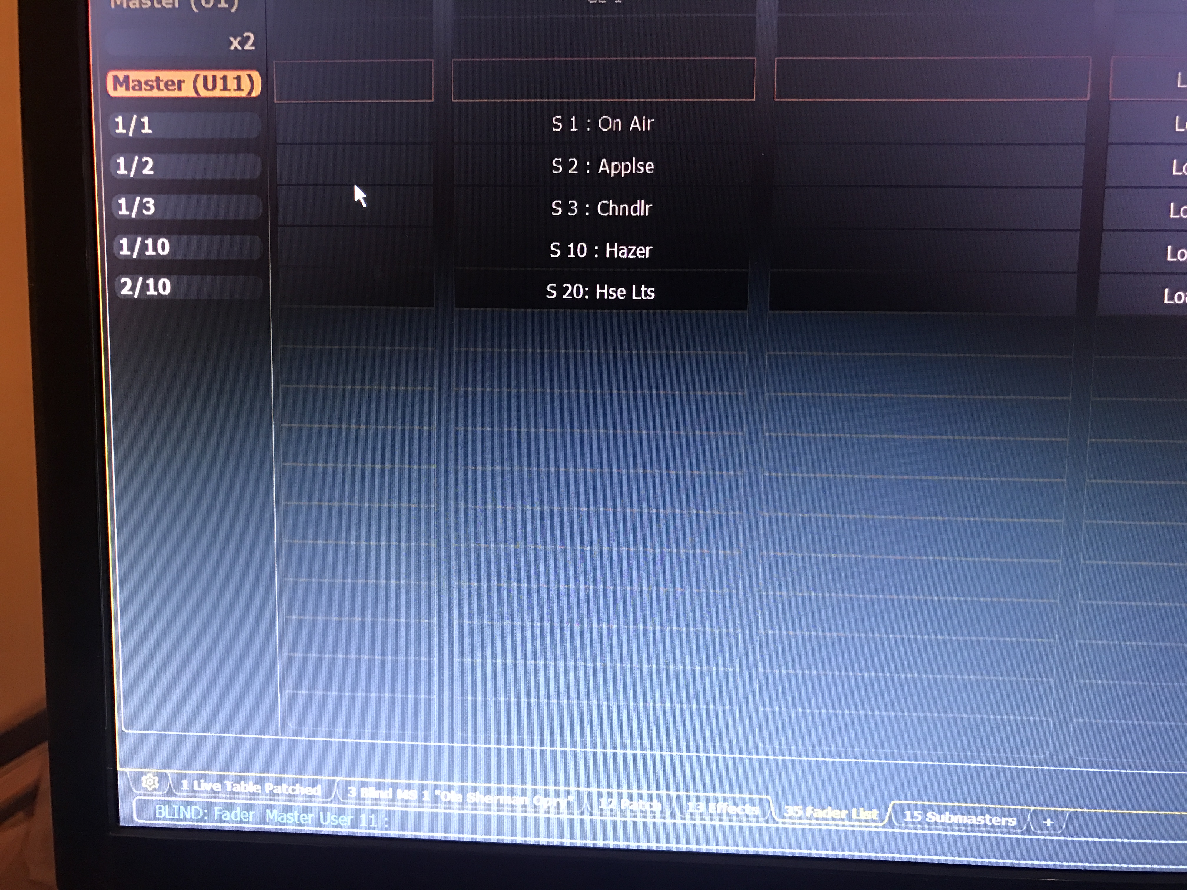

Initial screen. I have no idea why master (U11) is there or why it is hi-lighted.

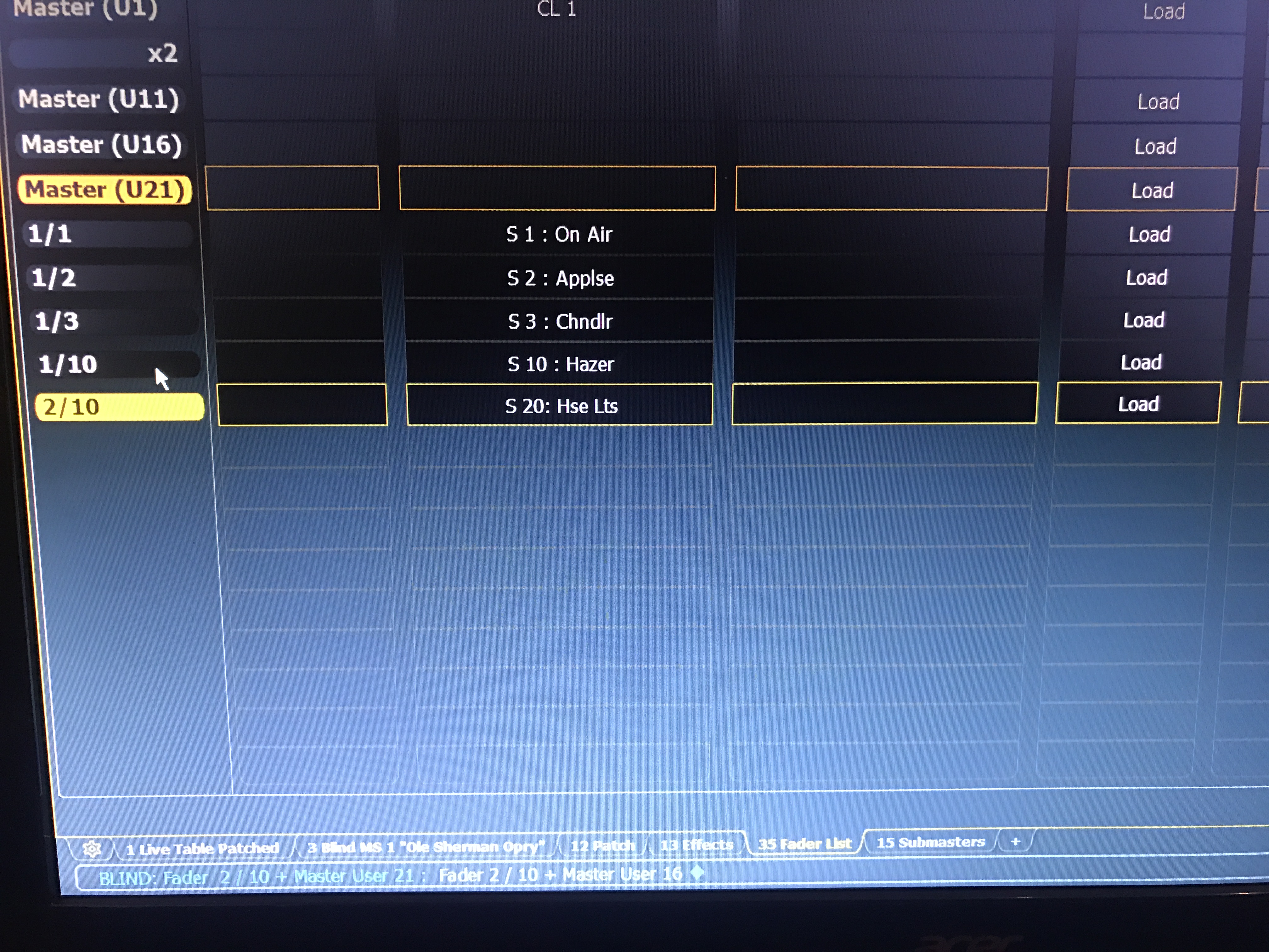

I click on sub 2/10 and master (U16) self generated
I clicked on sub 2/10 again
and once more on sub 2/10

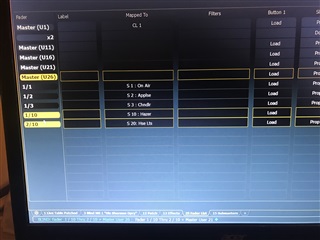

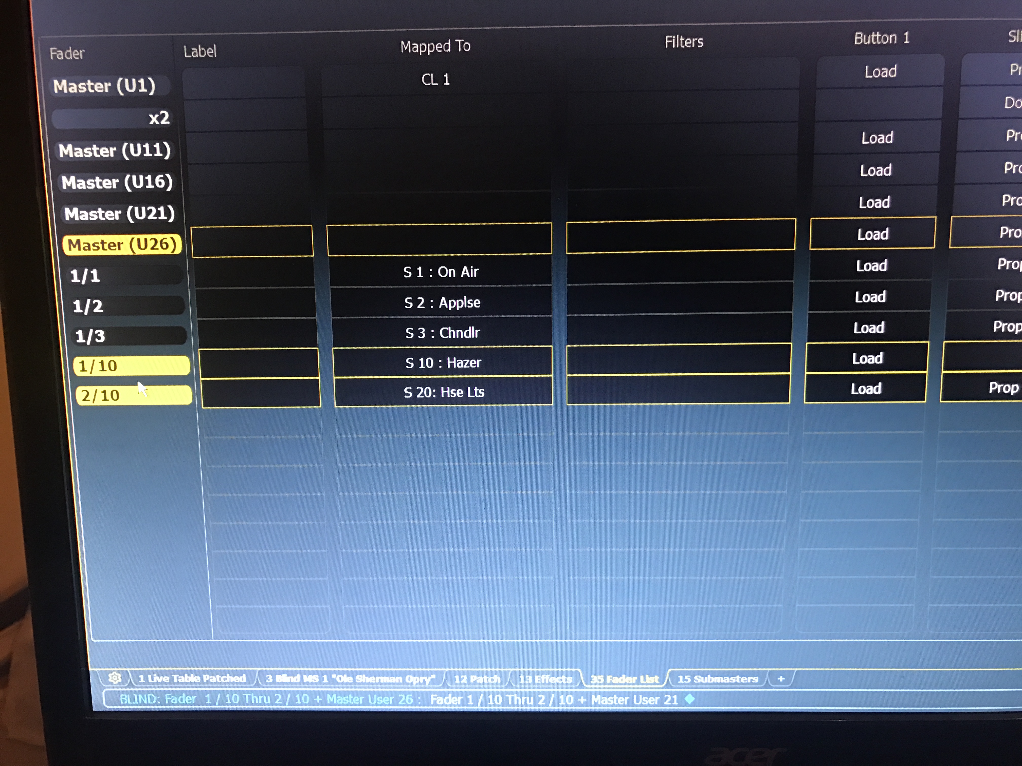

clicked sub 1/10 next (for variety)

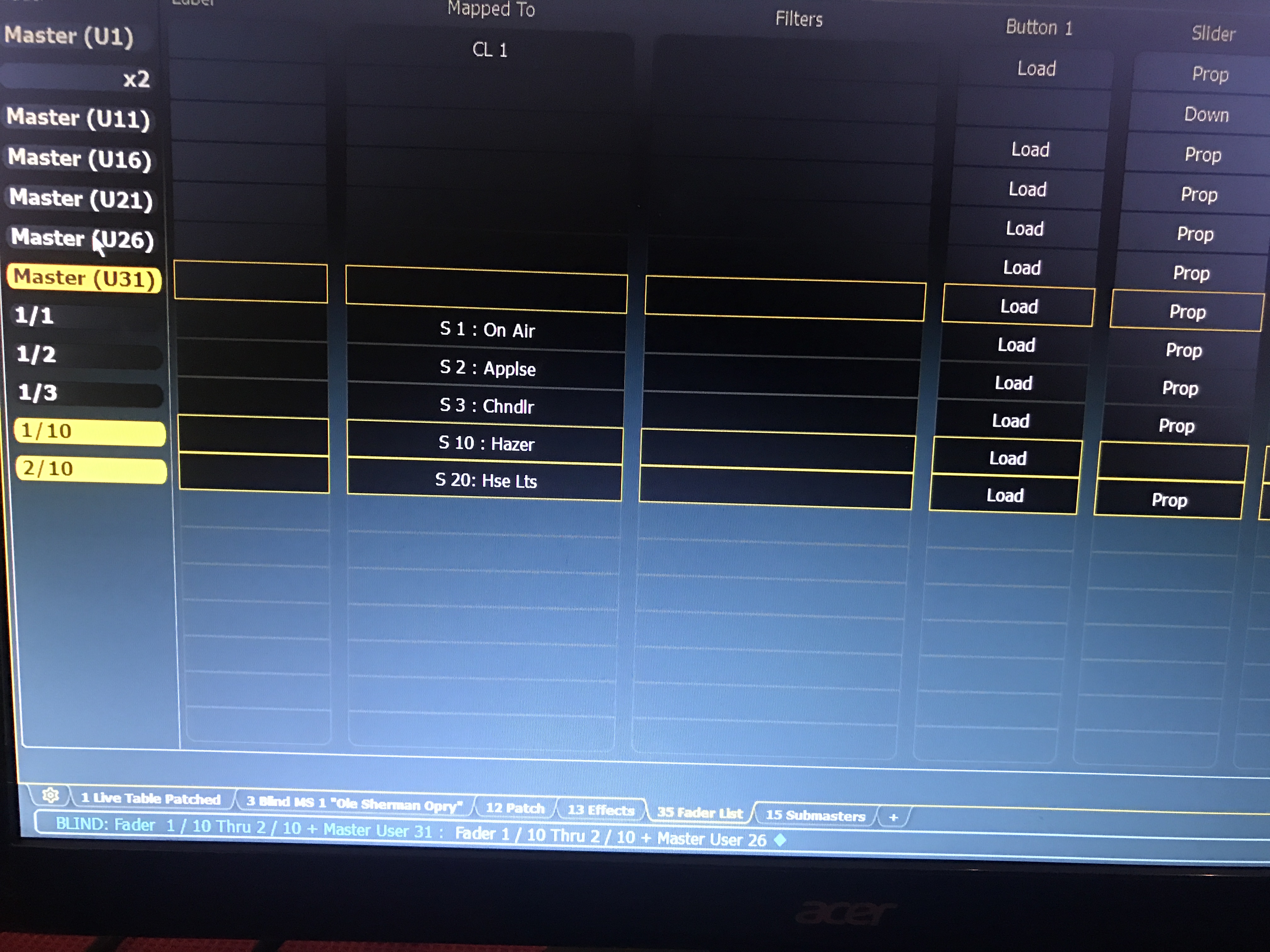

and finally clicked master (U26) twice

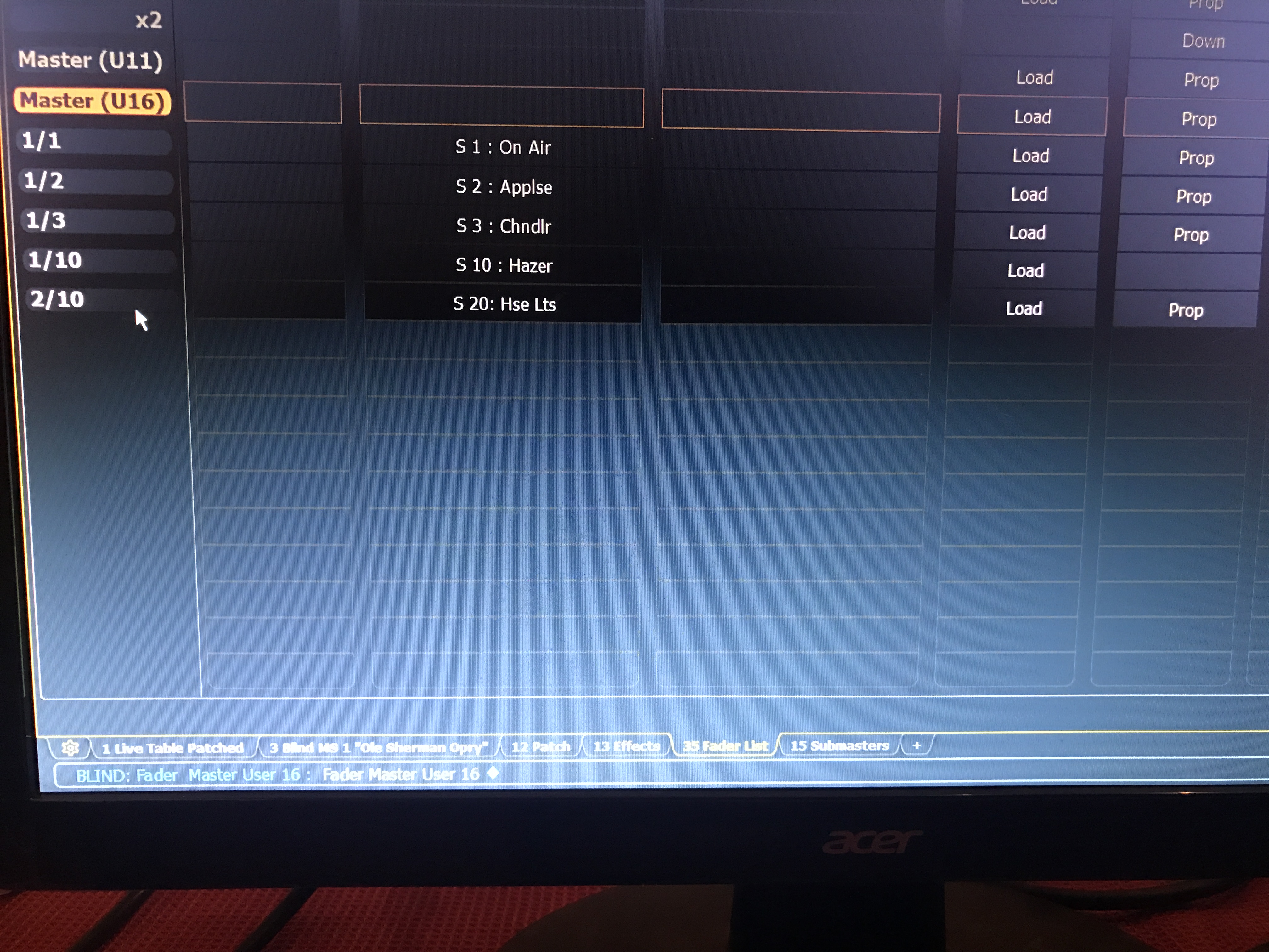

Also- if I hi-light one of the masters, push the Delete facepanel key, double tap enter the master will disappear.
If I bring up any other tab, then go back into tab 35 the master that I just deleted reappears.
