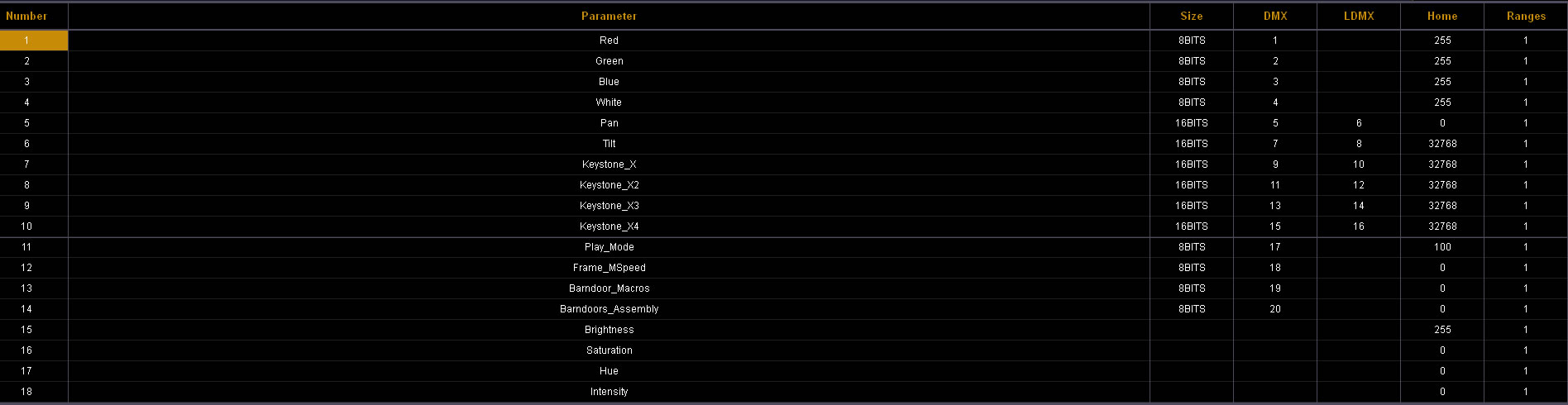

    I encountered exactly the same problems with CS-4s on Eos, and needed to created a custom profile for them to be controllable:
    1) I mapped the Intensity channels to Color R,G,B & W. Although this sounds weird, this worked out OK because the console provided mastering of the RGBW outputs via the intensity encoder. So for each CS-4 channel the intensity wheel controlled the overall output of the 4 lamps, and the RGBW parameters give me individual lamp control when I needed it. It also meant that [Select All][Out] commands, etc.., did black-out my entire rig. It also meant that I could run a lamp chase using the RGBW parameters, and use the intensity wheel to control the overall level of that chase.
    2) I mapped the 4 Pan channels to beam attributes, just so that they appeared on the Beam encoders. (Interestingly, Ion has a Focus page of encoders whereas Eos doesn't). Global Pan / Global Tilt were just mapped to the normal dedicated pan/tilt encoders.
    The custom profile we created did make the fixtures infinitely more controllable, and I would guess this is probably the best way forwards in the short term. I've attached a screenshot of the profile we created for the fixtures. The attribute mapping and home values should largely make sense. The higher DMX channels (17-20) are just mapped to random attribute names, and to be honest I didn't change these attributes at all - though they were also available on encoders if required. The virtual brightness, saturation, hue & intensity parameters are added in automatically by the console.
    Hope this helps - I'll also try finding you a show file with the profile in that you could import if you wanted.
    Cheers, David.
