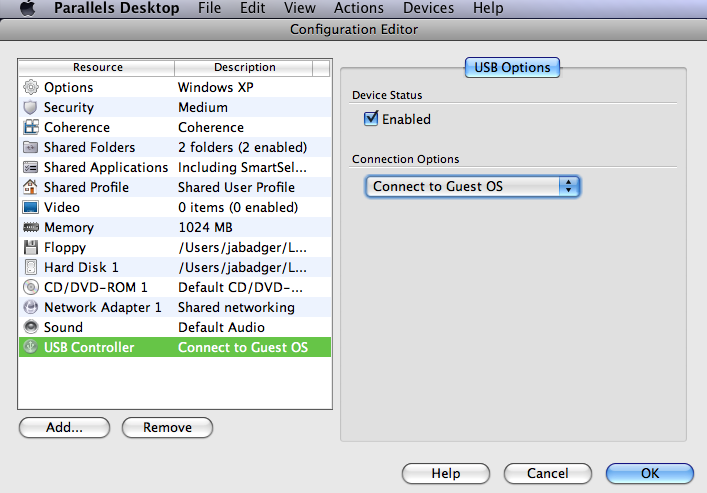

  • Just as a Note. It is possible to KEEP the OSX HASP driver. Because I have several different HASP keys, I need to have the driver on the mac side.
    To make windows accept a hasp key and to 'release' it from the Mac control you need to access the virtual machine setup in Parallels and under the USB Controller setting before Windows boots.
    Set the drop down to "Connect to Guest OS", hit OK and then Start Windows. You cannot just change it in the Devices/USB menu after you have already booted windows.
