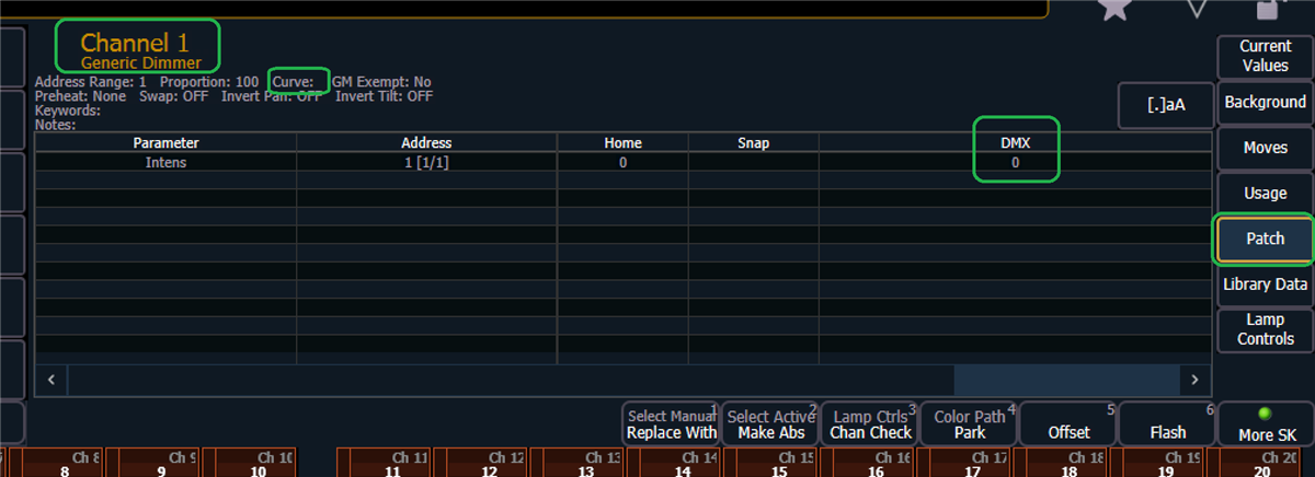

    Select one of the misbehaving channels, [Live], 1 [Enter]. Press [About].
    check if it is says that Channel 1 is a Generic Dimmer and check if there is a Curve mentioned.
    then click on Patch on the right hand side and while fading keep an eye on the number in the DMX column. does it fade or does it follow real life?
    if it fades while real life switches then i claim it's not the console but e.g. a dimmer setting.

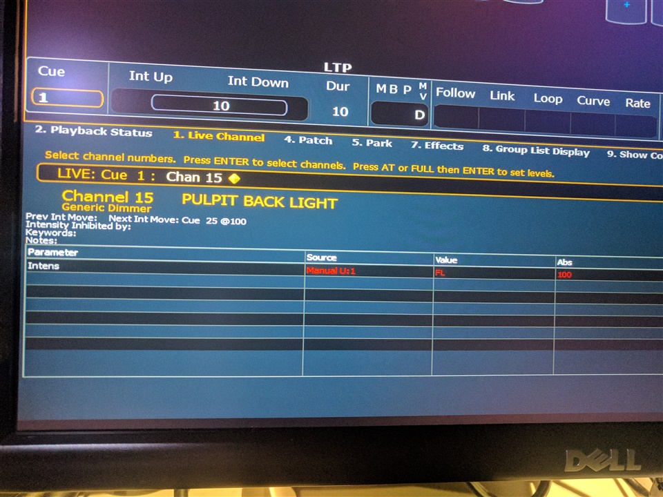

  • These are the older style lights. It is set as a generic dimmer. I've attached a photo of the screen (Sorry, unable to get a screen shot). The dmx values change when scrolling but I'm not sure what you mean by real life.
  • The receiver of the signal your console sends is a dimmer. It translates the low voltage digital signal to different voltage your spotlight gets. Think of your dimmer as a valve that relates the power that's sent to your spotlight, and it is remote controlled by your console. The dimmer has something called curves, which is a translation table between the incoming signal and outgoing power. Your dimmer could be set to a curve called Switch, meaning that the power doesn't rise proportionally, but stays at zero a long time and then switches from 0 to 100 instantaneously.
