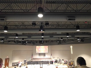

I am very new to lighting and am using an Element 40 for my church.  I'm unsure what method is the most efficient way to run my lights. We have 6 moving led fixtures with the house and stage lights. I change the light intensities and colors 5-10 times throughout the service if a video is being shown, the choir is singing or the color on the walls to match the projector colors. The moving lights only move to provide additional white light to the stage areas
Currently, I have been programming cues and overwriting them every week for the different colors I need. This causes my cues to be out of order so I jump around using the goto cue function. Is there a better way to run things? Should I be using submasters or paletts? Is there an easier way to change colors then creating an effect for each one?
