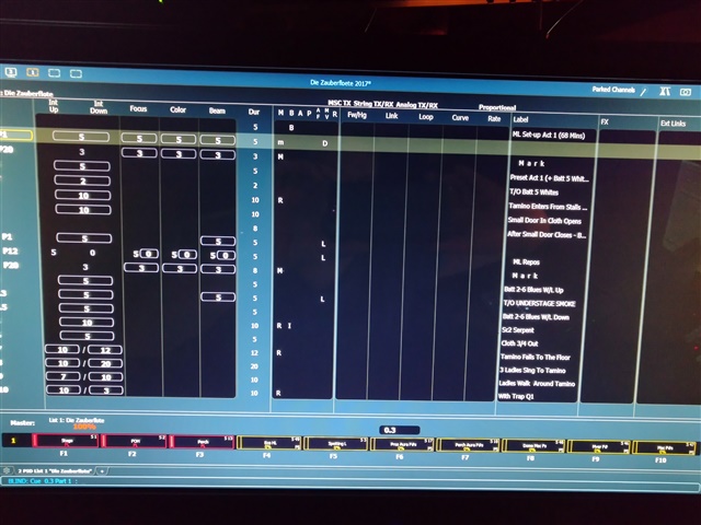

 Hi all,

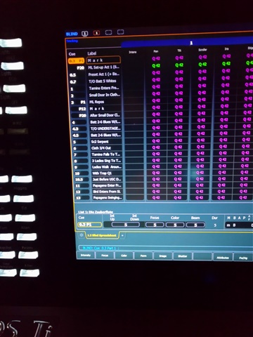

I came across the following annoyance. If i have a cue with multiple parts and i run my macro to insert a part 20 and label it 'Mark' and mark it in blind spreadsheet the cue labels get all jumbled up. For a better explanation with fewer words please have  look at the attached pictures. The cue you can see it best is cue 3. In the PSD it is the way it should be. Closing the Blind spreadsheet and re opening it does not help. Also a deep clear did nothing...
This show is a revival and I am in the process of turning it into a marked show file, just in case one was wandering why I have part 12 ML Repos... ;)
