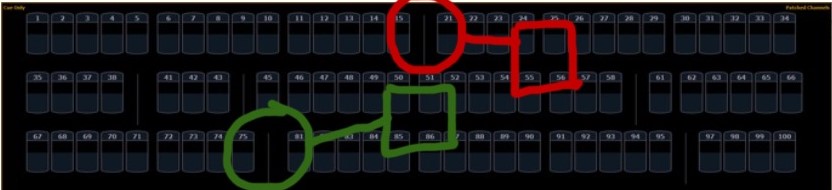

-When in a Flexi and you have "Group Channels by 5" selected, if there's a break in the channels at the beginning on the group of 5, it shifts the rest of the row over the width of one gap between group of 5. This doesn't happen if the channel break is at the end of the group. (See Image 1)
