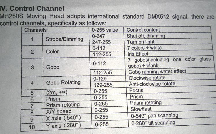

Im a bit confuse how to make fixture "Involight MH250S", directly such parameters like color and gobo.
In the attached picture you could see that there is two separate modes in one parameter.
How I understand,
Color = Color Select
Gobo = Gobo Select,
where every step in user min-max column have unchanged values like 0.5-1.5; 1.5-2.5 etc...
So, adding steps with another range looks like impossible.
How I understand its going to make additional parameters without dmx adresses like "color mode" and "gobo wheel mode"
like it is in another library fixtures, which are grey. But it doesn't work - it makes absolutely new separate parameter.
1. Which way is the best in this situation?
2. If I try to change copy of library fixture I couldnt change ranges or delete this grey "color mode" and "gobo wheel mode"
even if I will delete major parameters with which they are works together. Is it possible to fix it?...
