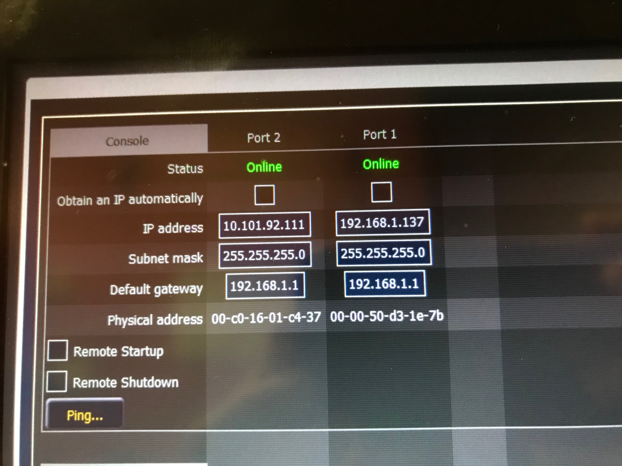

So, in all the time I've worked at this venue, we've been able to use our iPad and connect to the network no problem, but, ever since we had to unplug everything the other week for a renter to connect with their console, we've lost that ability.

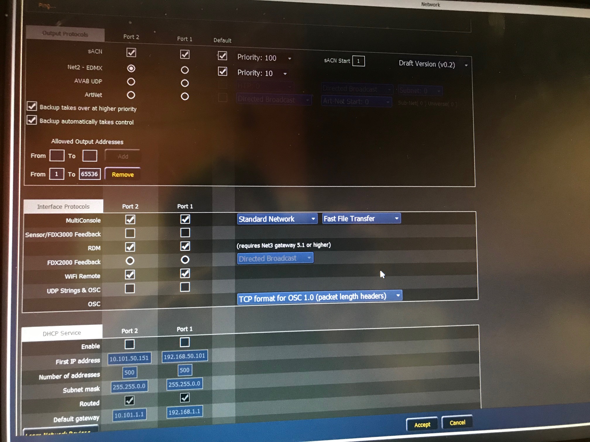

Immediately afterwards we had an intermittent control problem that caused everything to turn on and turn off, so our TD reset the dynamic IP address in one of the ETC DMX nodes by our board. Now everything works, but anytime I try to connect to the network with the iPad, it fails.

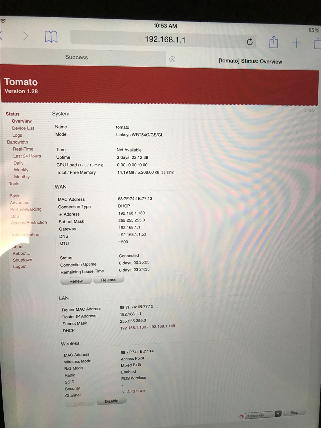

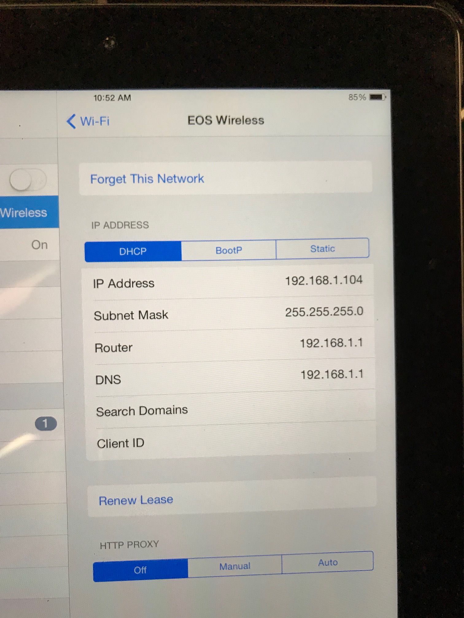

The board is connecting, and it says "online" for both ports in the settings. I've changed the IP addresses, changed the IP in the node again, reset the router to factory and back again, and still no luck.
I feel like this should be an easy fix that I'm just too dense to figure out. Any ideas?
Thank you!
EDIT: FIXED! I had to change the router's IP address and the gateway to all match. At long last. Thank you all anyhow.
