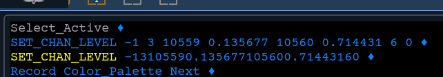

  • I too am trying to select a standard color in a macro.
    When I pick the color the editor displays the second line of the screen shot below (as ChrDuda explained 7 yrs ago).
    When I click the Done SK, the text is reformatted as shown in the 3rd line.
    The macro works fine with a gel code, but not with this format.
    Is this bug?  Or as designed and I'm doing something else wrong?  Can I prevent spaces from being removed?  Can I manually type spaces in a macro script and write the coordinates myself?
