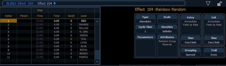

    This shot is my standard lightning effect. I built it for fixtures with a strobe channel but decided that the regularity of the flashes was too noticeable and that the flash duration was generally too short. You may choose otherwise or even build several variations.
    This effect is a disco party look. All channels chase through color palettes but each channel is a random color. A few tweaks and you could have a random flash. Perhaps intensity palettes or presets with just one fixture on instead of the color palettes.
    Random brightness is a bit harder. You can't have more than one effect on a single parameter at once. Without a better idea I'd do something like the color one above, but use a really long list of Actions and just type in a seemingly random list of times and levels. That way there would be very little repetition and so the audience wouldn't notice. Theater Magic!
