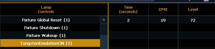

Hi Andre,
it appears there is a small bug here. We are trying to figure out how to get this solved. A possible workaround for today,
is that you edit the Lamp Controls in the Template and INSERT a new Control - call it TngstenEmuON (this exact Name doesn't matter) and have it
use a TIME of 2 seconds, and DMX 19, and Level 72.
Then do one for the OFF, as Level 73.
Then you will find these two new commands in Lamp Controls.
Remember with Eos v2.7.0 you no longer need to copy templates to edit them.
Thanks for the Info about the bug! - and sorry that you had to find it.
