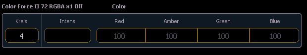

Problem: When you patch new LED fixtures, EOS has a tendency to leave some of the NPs off of the display data view.
e.g.: You patch a Colourforce II and it shows you the values for Red, Green, Blue, but omits the Amber.
You need to Hold the Data key & select the virtual buttons of the parameters you wish displayed.
